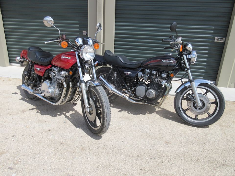

I'm looking to order carb kits/jets/parts for '76-'77 era 26mm Mikunis for KZ900. Are there other options besides partzilla and Z1e? It's been quite awhile since I last ordered carb parts, and wondering if there are any other, or new options out there. Thanks in advance. (pictured are my 2 babies, 'Cracklin Rosie' (all stock) and 'Bro' (slightly modified LOL that I built from a bare frame).

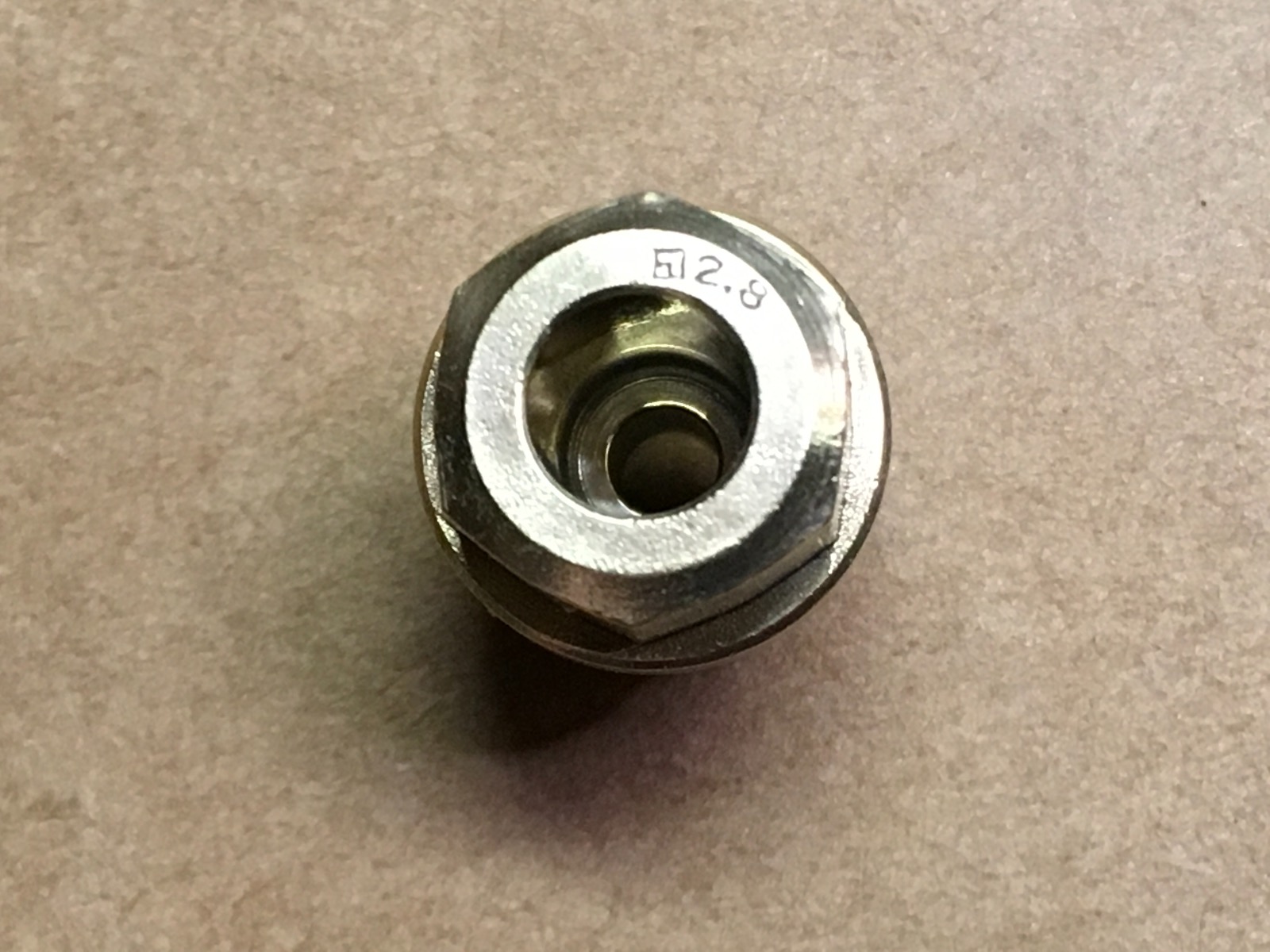

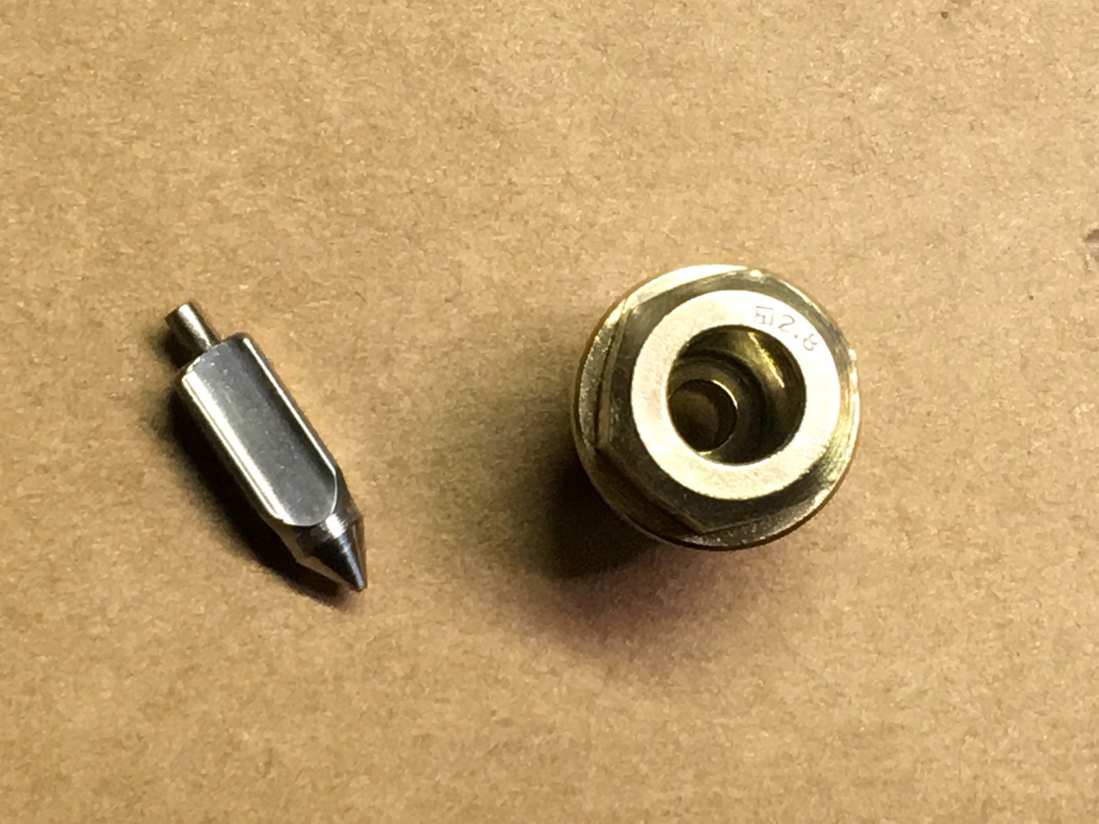

EDIT, check the jet needle. Run your fingernail up and down at the bottom (thinnest part) your looking for a wear mark from the jet needle rubbing on the needle jet. Not real commen but it does happen. If you find a flat spot then push the jet out and inspect it. There is a number on the jet needle to get replacement. They can’t be fixed. Same with the jet, has a number on it. I’d suggest polishing the float needle and seat. Cut Q-Tripp’s in half and chuck them up in a drill. Use some mothers aluminum polish on the Q-Tipp in the float seat and clean them up till shiny. Then very carefully you can put needle in the drill chuck and polish them up with some 3000 wet sand. Be sure to keep the needle with the seat as a pair. Never mix them up.

Thanks for the reply, but I'm aware of originals being cleaned and reused. I've been doing that, when need be, since the mid '70's. I was also thinking of alternate jet sizes (pilots/mains) etc, for alternate tunings, not just replacing old ones, as well as returning previously altered carb configs to stock. I have others (carb sets) and wasn't necessarily referring to the 2 pictured. I bought complete carb kits before, but it's been several years and I can't remember who it was. Thanks again.
