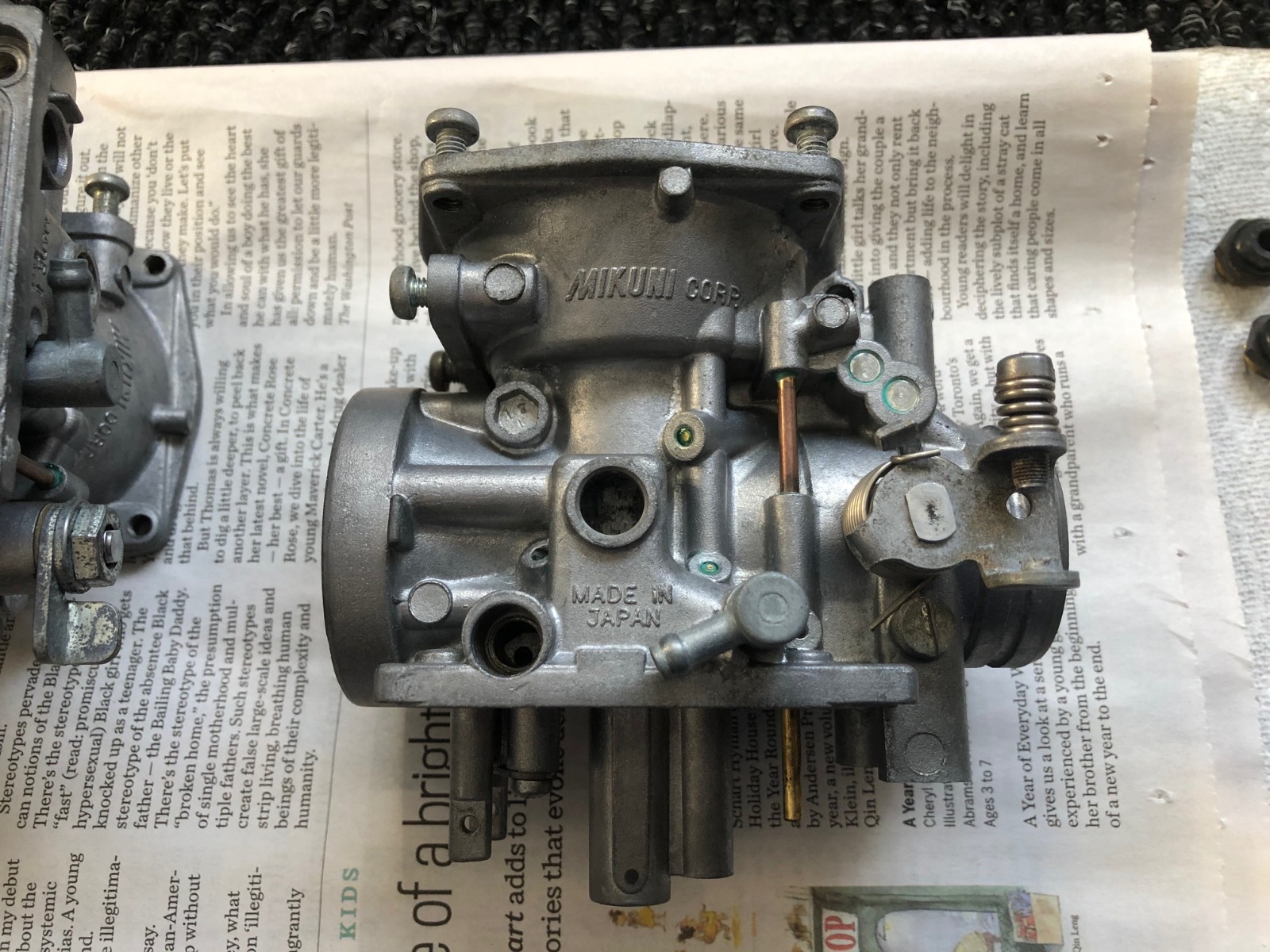

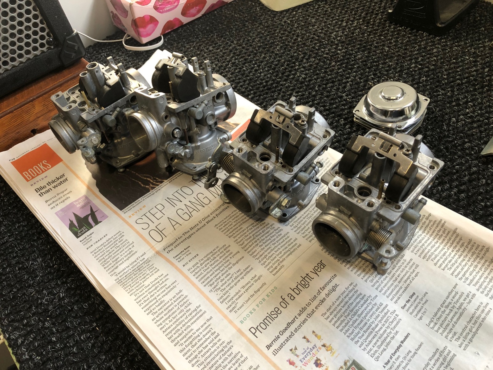

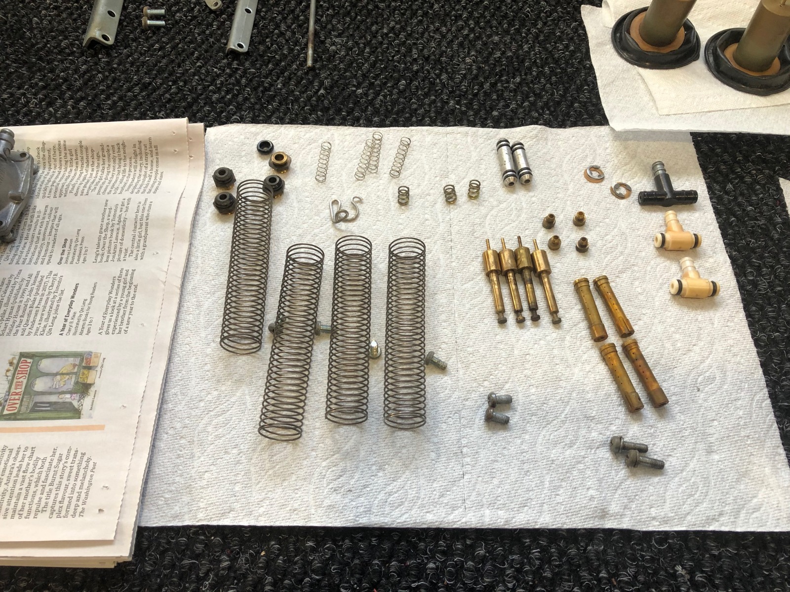

These carbs in the photos I purchased used for $50. Actually them and a nasty set of keihin carbs that also need s tear down.
All parts of these Mikuni carbs seem to have cleaned up very well other than the float bowl gaskets. I need new ones and am stumped as to how to remove these old ones?

Can I assume that what I have is Mikuni BS series carbs as seen in the picture? These are NOT the carbs that came with my CSR650 but look pretty much identical.
Would the BS series float gaskets be a standard fit for all such carbs? The rest of the parts have already cleaned up nicely.

I can't say difinitively that all BS gaskets are the same but most are. There may be different passages, which correspond to different holes through the gasket, so pay attention to those when ordering. Within the KZ line there are a lot of years of bikes that shared the same gaskets as the 1982 KZ650 CSR...
