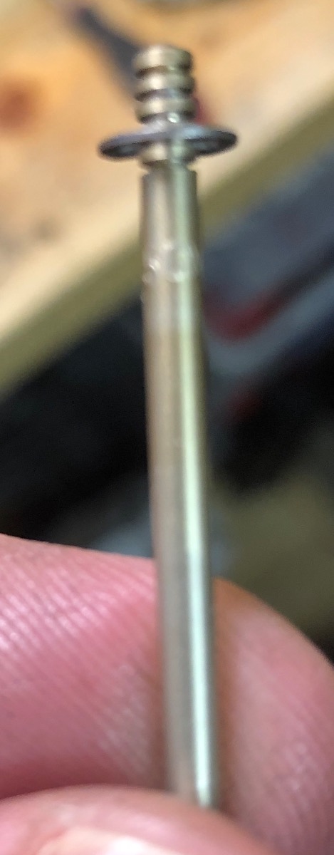

Finish with carbs today:
1. Installed 15 jets
2. Raised needle to stock
3. Pilot screw 1,5 turn out.
4. Main jet 112.5 (not changed).
It’s winter here now, but can I start the engine and let it be warm and then sync the carb without driving the bike?
If so will I be able todo most as possible before spring comes :)

Re: 810cc and VM24 jetting?
24 Feb 2021 16:53
#844037
I say Yes. I have an old blower cage out of a furnace that I set in front of the bike to keep it cool because the sync could take some time to get it right. The cooler temps may make a fan less needed.
