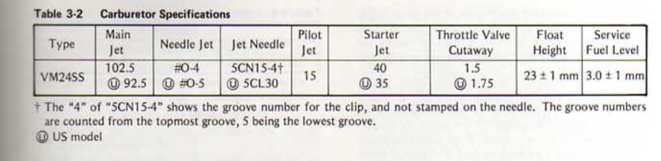

If you have 810cc bigbore with VM24 and 4 to 1 exhaust. Quality pods with air corrected jets (setup should be similar to using stock airbox)
What jetting should I use then?
Right now:
Pilot: 17.5
Main: 112.5
Needle: 4th posistion
Should the pilot be smaler and main stay?
Right now:
Pilot: 17.5
Main: 112.5

As i stated in the other thread.
You should put all the setting to stock 650 as a baseline and increase the mains for the capacity increase.
The air correctors richen up the bottom end so fitting bigger pilots coupled with these may cause over richness .

So I should go back to pilot 15, and stay with 112,5 main?
I understand 102 is stock (650) so going to 112,5 its a increase of 10,5 for going from 650 to 810 and 4to1 exhaust.

If I have understand Zed correct shall I go back to stock (650 setup) for pilot (15) and leave the main jets (112,5) correct?

31 Jan 2021 02:58 - 31 Jan 2021 03:14Mikaw wrote: . It’s not just the main jet, it’s the stack effect of all needle and jets combined that need attention to tweak performance.
EDIT, the air corrector jets are only for the pilot circuit. They my help transitioning from pilot to the main circuit but installing them has no effect on the main jet.
As you say, The stack up of all the jets add to the final size needed for the main.
In the case of the air correctors these do affect the eventual size of the main as the richening effect on the off idle mix does transition to a lessening degree throughout the rest of the fueling
In comparison to the more complicated ,less refined and crude method of lifting the needles and fitting larger pilots to try and smooth the off idle hesitation the simple use of the air correctors often result in being able to use a slightly smaller main .
As mentioned previously Gordone, You should retain all the carbs stock settings as a baseline and start with only increasing the main jet as you have for the larger capacity .
Once you are satisfied with the top end fueling you should work down.
Any slight changes needed to richen the pilot mix should be able to be covered by adjustment on the air screw.

So I will go to stock pilot 15, I need to order 4 15 jets.
From reading what you saying, it looks likte it`s a big posbility that the main jets is to big.... undersood correct?
I have spare main jets in size 120, 117,5 and 115...
So what I wanted to ask about, then when I first have to import jets from US, its way cheaper also order main jets at the same time.....
Stock: 102
Right now: 112,5
So the questions is what main jet sizes should I purchase to be covered in the tuning in the spring ?
Stock: 102
Right now: 112,5

I would say that those 112.5s to 115 are around where you need to be.
I would buy some 110s but i think you are pretty much covered with what you have and you may not need them.
Every set up is different and until you actually run the bike it's just an educated guessing game.
Just be sure to start a little large on the main and work down.
