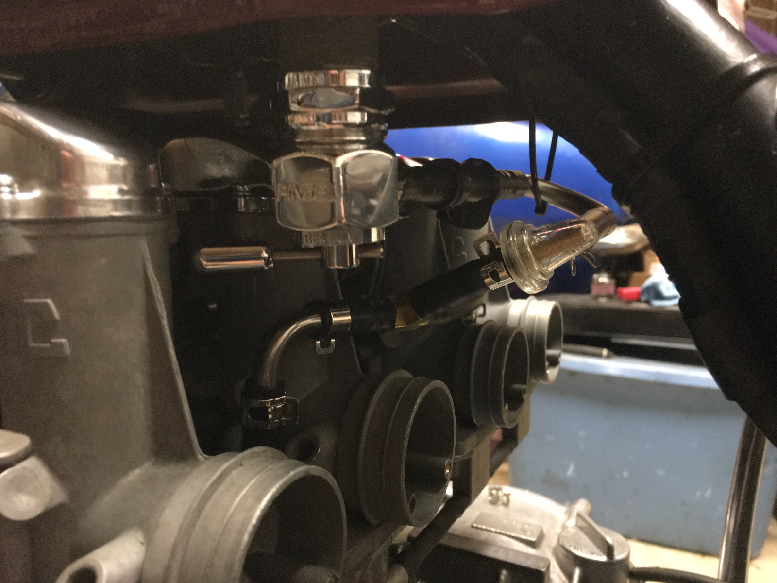

I took Ed’s advice and extremely happy with the outcome. I added a dry break quick disconnect to add in tank removal. I used all 5/16 fittings.

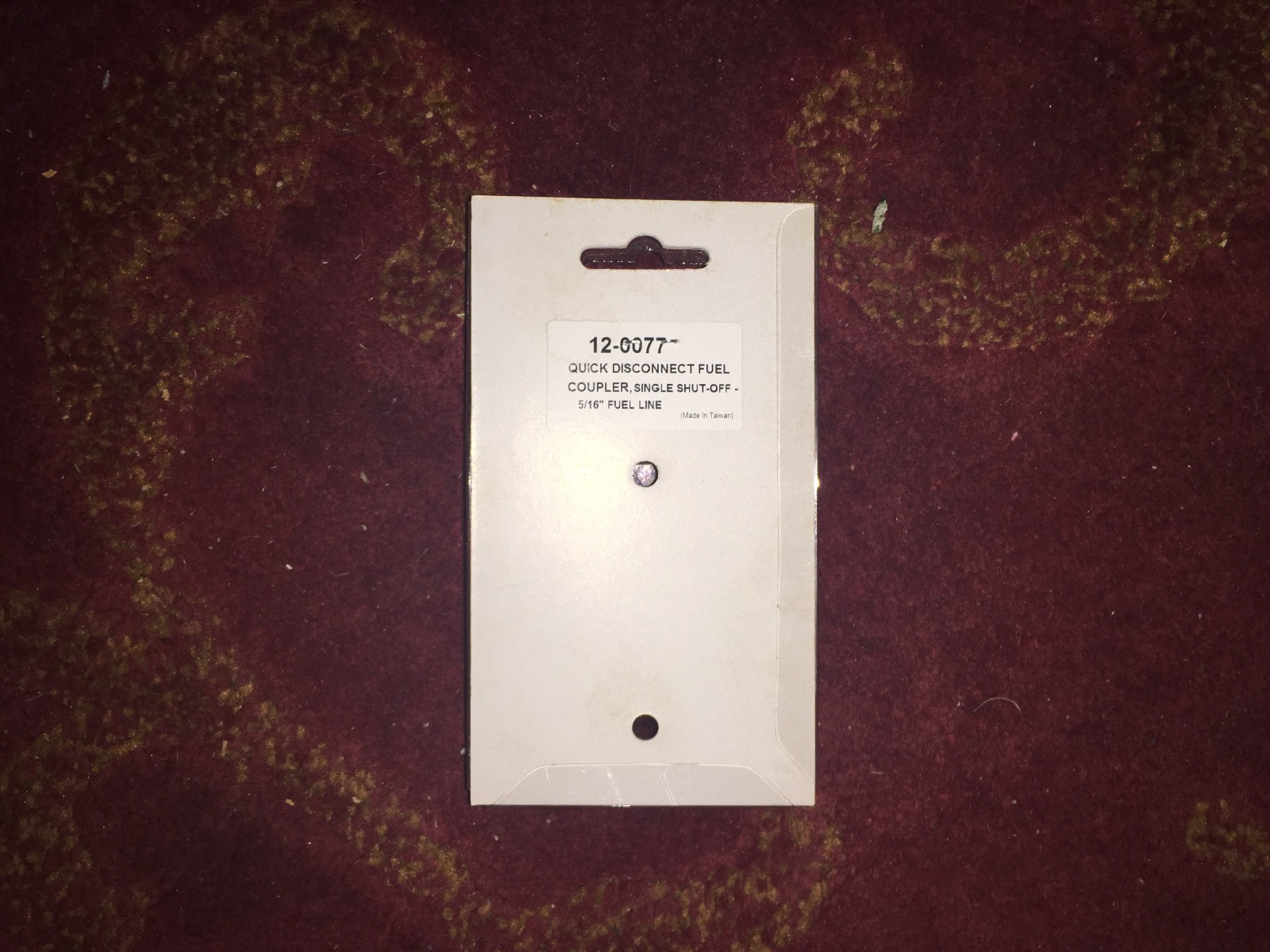

Kaylinator at work. I’ll look it later and get back. I know I posted it in another thread. I’ll find it and as our new press secretary says “circle back on that one”

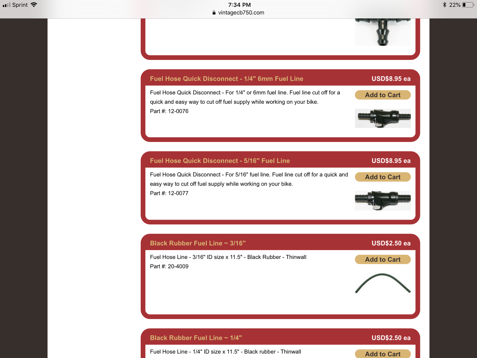

03 Feb 2021 16:36 - 03 Feb 2021 16:37Kaylinator wrote:Mikaw wrote: I took Ed’s advice and extremely happy with the outcome. I added a dry break quick disconnect to add in tank removal.
Where'd you find the disconnect Mikaw? I need to remove the tank to re-torque my valve cover, and just keep procrastinating because pulling the fuel lines is such a pain.
Here ya go.
www.vintagecb750.com/products/6/fuel-sys...el-line-fuel-filters
