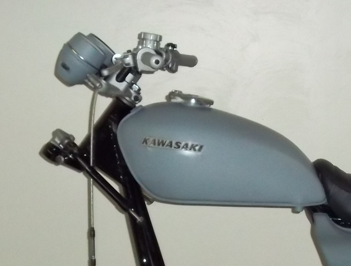

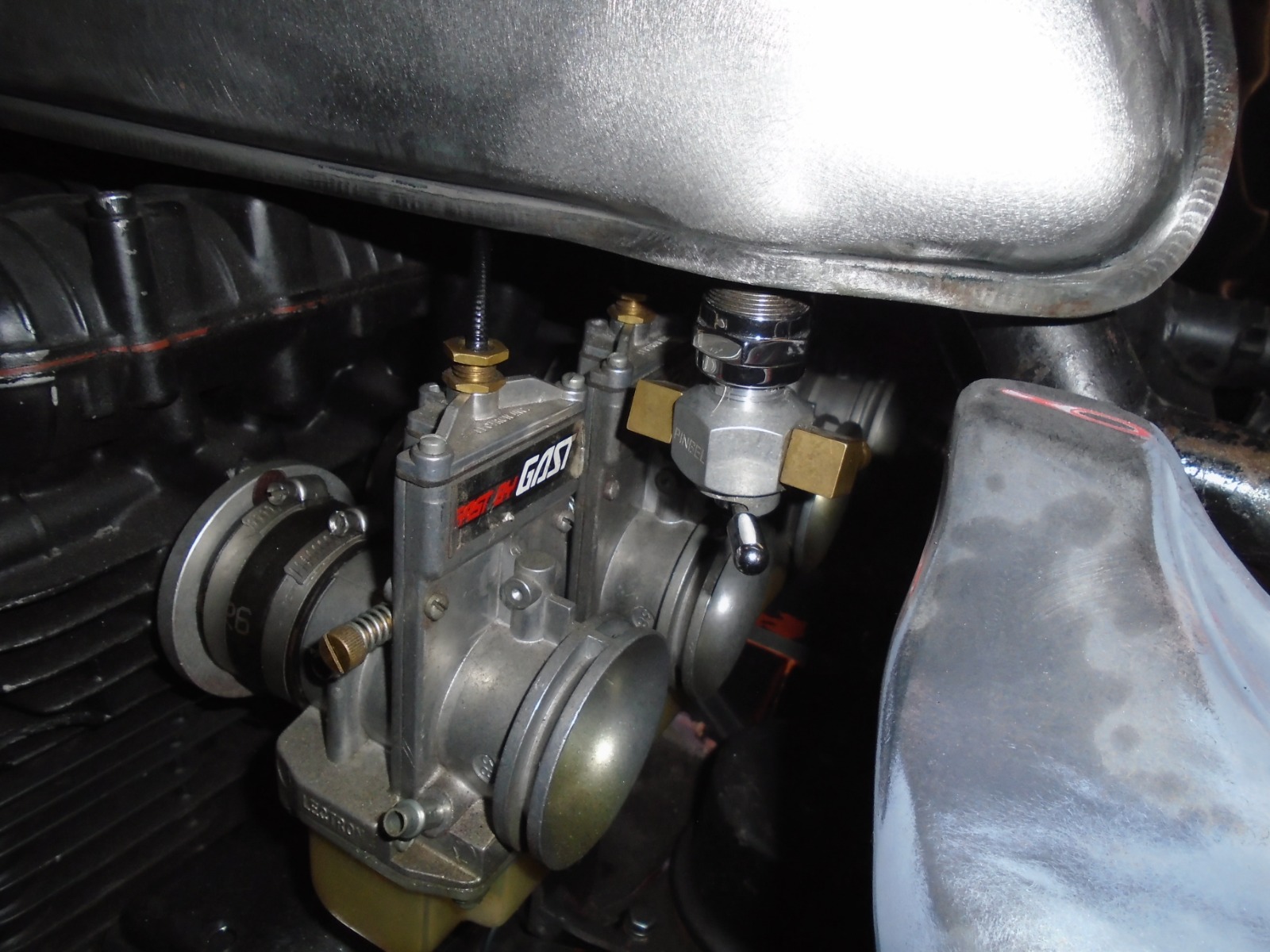

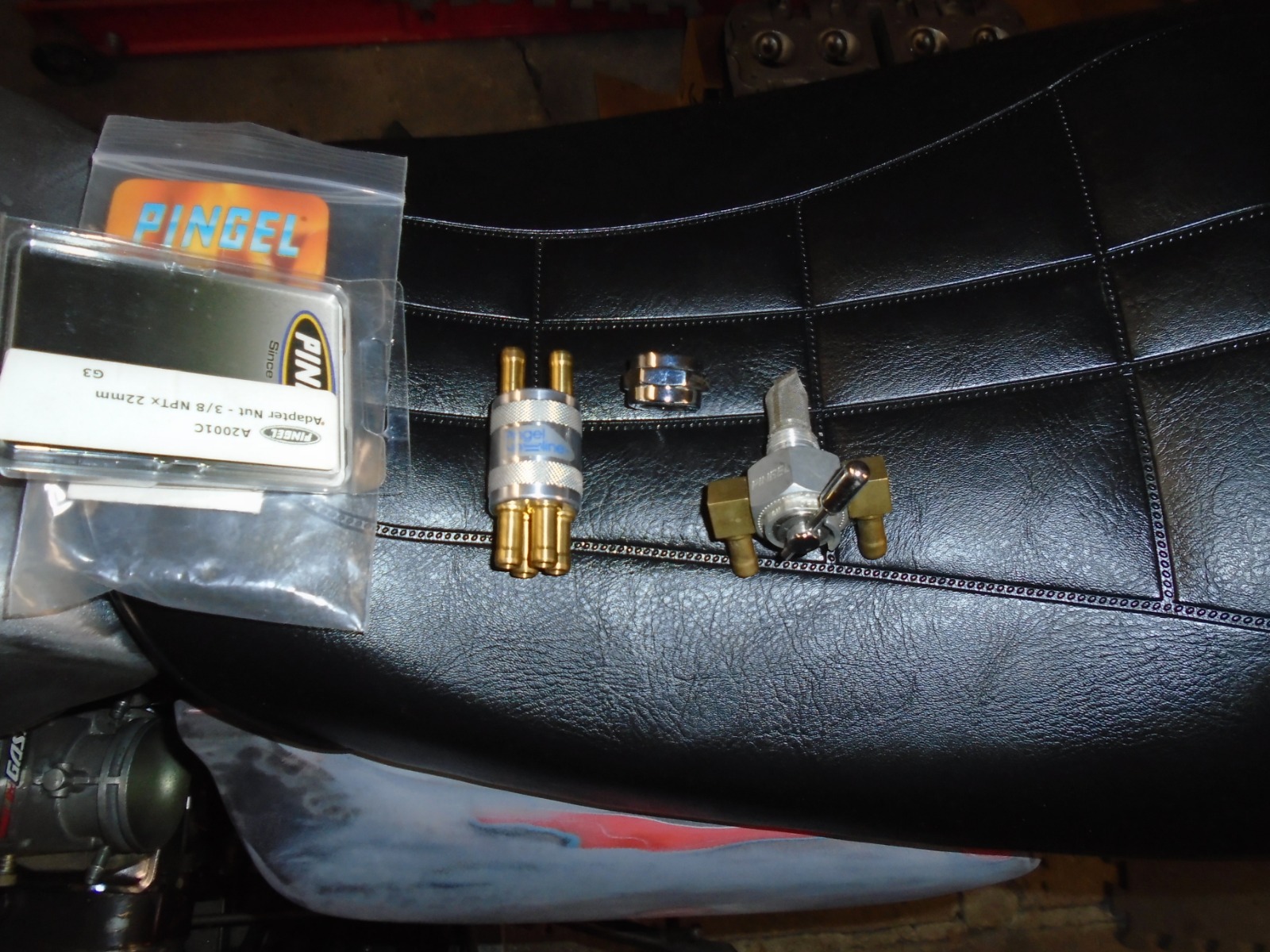

Great products PINGEL! I always use my 'wellworth A2Z" to protect and lubricate Everything! inside, outside, house cellar cars, trucks, motorcycles! But first thing I did when I took these ones apart.. AsI am changing this bike around. Using small LTD tank, a little tight fit. So gives me the reason to Rake the frontend out, which means pulling the 2 studs with the rubber mounts for gas tank back about a 1/2" And I'll solve the clearance issue. I did that with my other bike up on the table lift, same LTD small tank. More work, more projects. I wish I had a neighbor, Kid - Teenager, start him on an apprenticeship program to do my work for me! Pay him with Pizza and Pepsi! Ya', right! kid would say F U old man! $20 bucks an hour. :laugh: :laugh:
