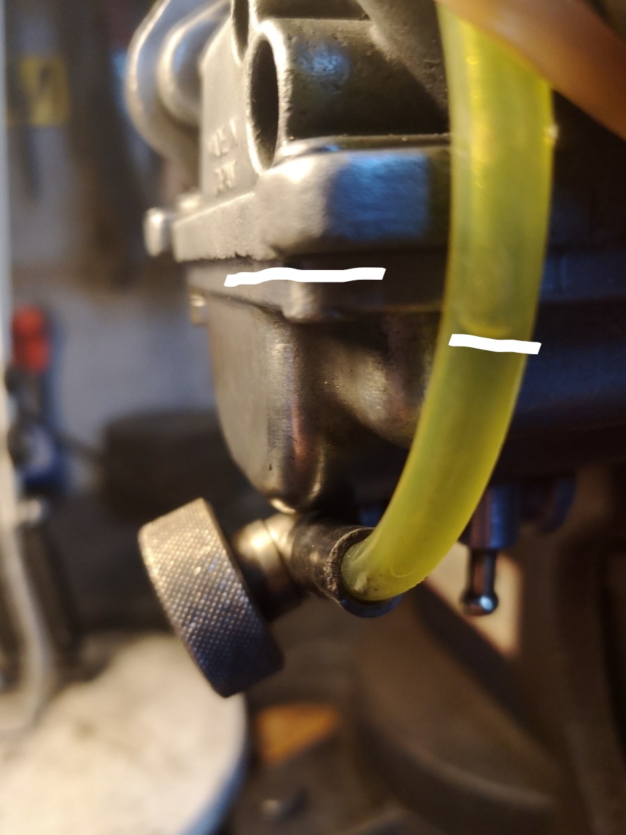

Checked floats, a couple of crooked ones, sorted it and went through levels again, all around 4mm below carb body fitted carbs bike would start, low fuel maybe, off they came and checked no 1 looks good will check the rest again, I'm going on the hayness spec.

A shot of the fuel level.

That looks more like 6 mm to me. You should be measuring to the bottom of the miniscus, not the top.
This is a much better (and easier) method for checking fuel level.
www.kzrider.com/forum/forum-index/3-carb...n-setting-fuel-level

Fuel level to low, the white line is at about 3mm, and the white line on the tube is where on the liquid you should reference from.

The only way to measure is with a ruler. Eyeball does not work. I learned that the hard way.
