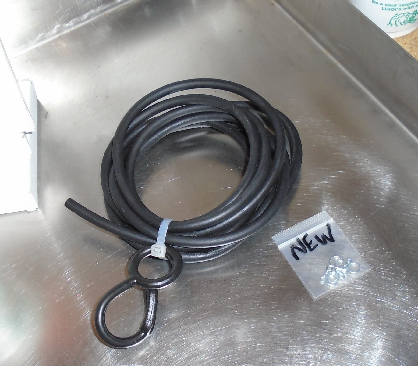

Question to be sure? 2 feet / 24" is enough length to complete the 2 gas lines for stock 28mm Z1 carbs?
I am going to buy some, it's sold by the foot. Old brain can't recall? I'm thinking 18"
Thanks in advance. Pretty close to OEM?

I can't remember if I buy 1/4 or 5/16 inch. I generally make the line to the left side a bit shorter than the right side. 18 inches would probably do the job but why not buy 24 inches? It won't break the bank will it?
Edited to add that I checked one of my Z1B's this morning and found that I use the longer hose on the left side despite it being closer to the petcock. (left from rider seated position) The reason is because I put a large u-turn in the hose to prevent kinking before attaching to the petcock.

Hi HRM thanks. I am buying the 24" It's sold by the foot! Up to 3' length. Just thinking I only need 14"-16"
I'm trying to duplicate OEM line to add to a set of early 28's I am going to sell one of these ?? month's / year's? :laugh:
I already have some oem drain hose and new spring clamps

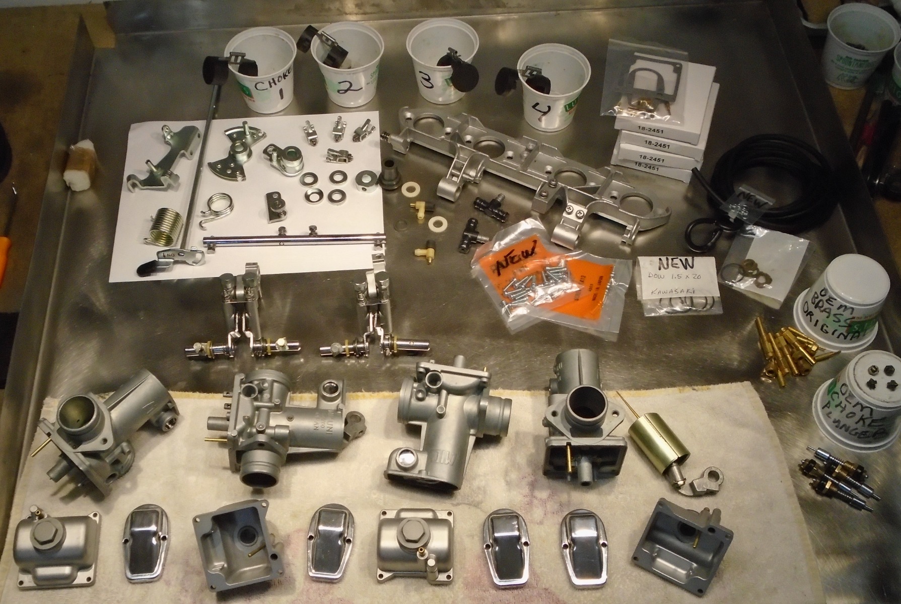

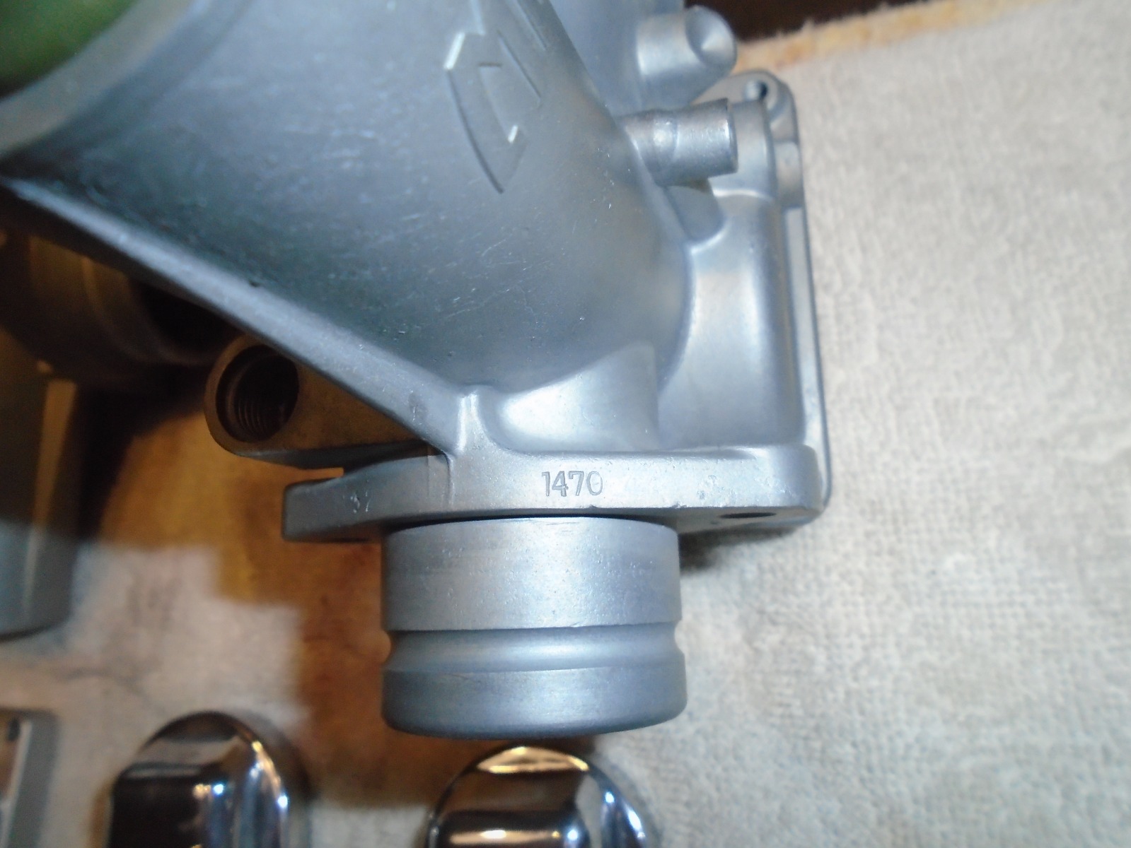

Not Rib less. I wish though. There have been a few sets sitting on eBay for a while. I have the second edition # 1470.
Same ones I was writing about last year when I made those .025"stainless balance washers.
Brazed choke rod. Been sitting in a corner of bench for 1 yr.! I have a lot of projects! :laugh: :laugh:

Those parts look amazing! Did you do the zinc plating? I've never worked on them....only the later Z1B version. Do the slides have a 2 mm cutaway?

I had the zinc plating done at a chrome shop. They are the 2.5 slides. Back in the early days we would turn .025" off bottom of slide and lower the C clip all the way down. These early carbs always sucked, cold blooded. That's why the factory used different sets every year. Check ebay! Not to pick on the guy selling early sets for $1,000. But he bead blasts his brass and steel parts like the idle thumb screw and leaves them brass? Without redoing the plating on them?

Z1 You "might" be leary of that fuel line. I know where you got it from and have had some myself from you know who. It splits at the fittings and i doubt it's really fuel rated, may i say it shares that "chinese rubber syndrome", and i think you know what that means. I know the original line at that ID vs OD is tough to find though. I use the Honda 95001-xxxxx-xx fuel line. I know you won't be the end user but.. The last set of the ribless went out just before the world changed. I have several sets of those 28's already done and have thought about putting them on the bay but prices have dropped so dramatically and fees seem to of went up. Just not that hungry to "give away" all that hard work involved, i'm sure You know

I have used a number of different fuel lines on my 1977 KZ650 over the past 43+ years. The very best I have found is the Goodyear 5/16" Fuel Hose SAE 30R7 Part # 65123. I installed it 8 years ago and it is still working perfectly with zero problems. Prior to using it I tried Gates Barricade and found that it really sucks! It has an inner sleeve that rolls up and blocks the fuel flow quite a bit. Is the Goodyear fuel line the exact same dimensions as the original? I don't know, but I do know that it works really well. Ed

02 Jan 2021 11:32asphalt900 wrote: Z1 You "might" be leary of that fuel line. I know where you got it from and have had some myself from you know who. It splits at the fittings and i doubt it's really fuel rated, may i say it! YES! I was not thinking that way! I was just trying to get the OEM look. I was just drawn by the price Shipped! I have plenty of access to any Industrial type hose, I have used ferry hydraulics for years ordering items for work yrs. ago That's were I found the overflow tube. neoprene / chemical.
Great wake up call! I'll leave the gas line to whoever or if? Buys them. When they are assembled of course!
Also! I am not going to set the floats at all with any type of liquids? Yrs. ago I took them apart, I marked each one's position, I did not do anything to them except a simple soapy wash. Plus with shipping nowadays! As to contaminate any shipment! They will smell gas in detector machines! Oh No! put DOT placard "1993" on it! That's Flammable liquid! / Or International????? As I'll offer these carbs to the World.
