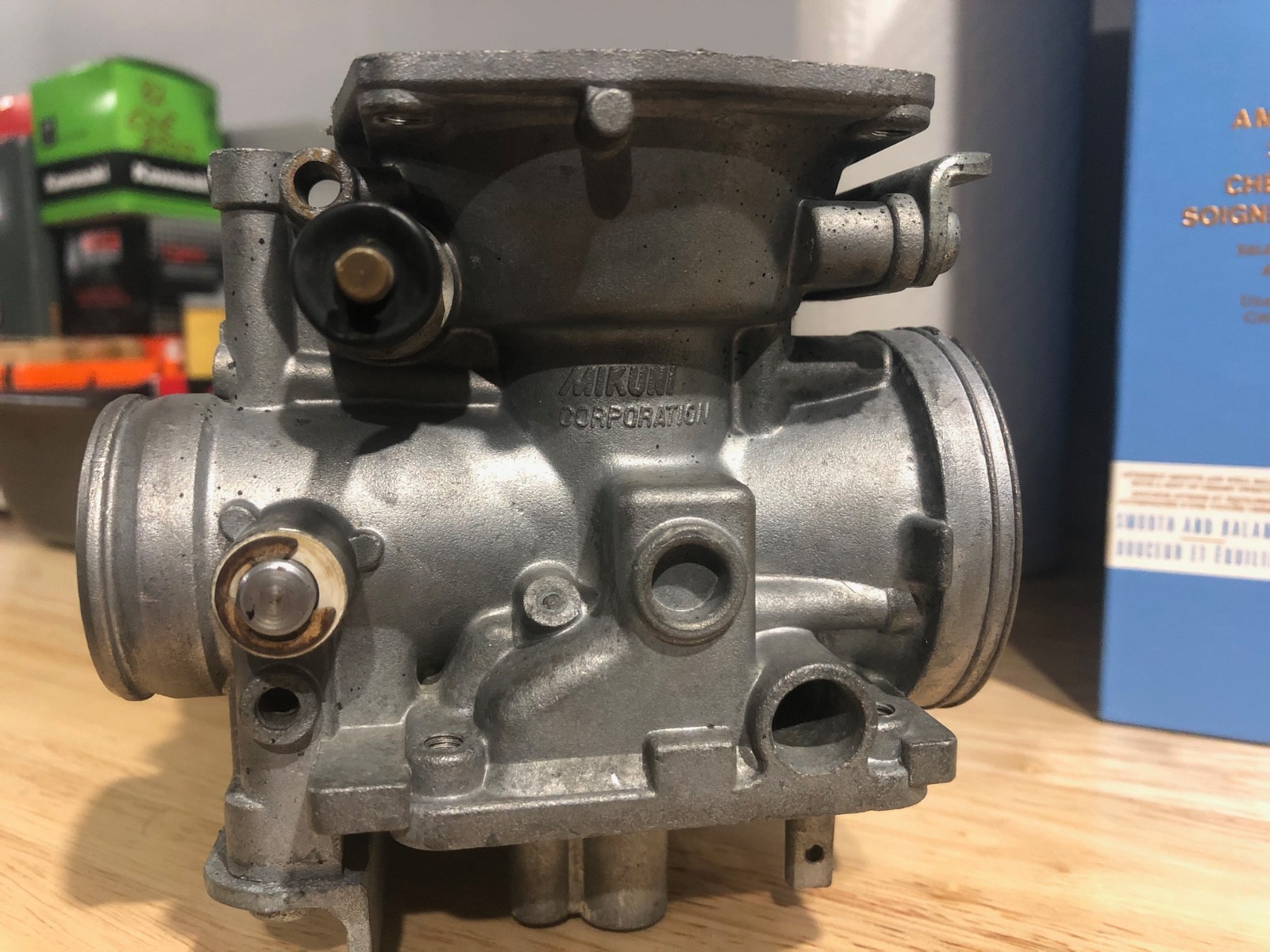

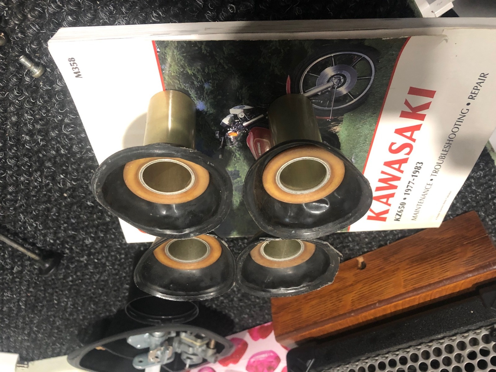

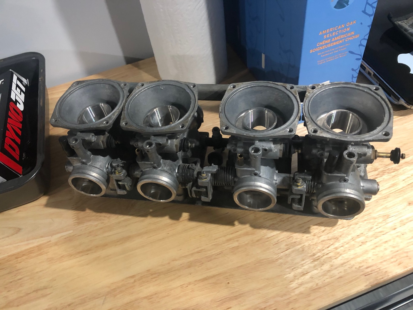

Here are a few pics of the carbs including diaphragms too. As I stated, they are soft and pliable with no tears.
Would any one know off hand what model carbs these are and who sells the best rebuild kit?

I think those are BS32 Mikuni's. And I agree that those slides look fine.

Something else you can do is hold each diaphragm up toward a bright light, and look very carefully for small pinholes of light coming through. If you do not see any, I'd say use em.

Those diaphragms look fine but just to be sure hold them up to the light (dont melt them ) and inspect for pin holes. If they still look good then avoid friend of friend.

Photos show the classic Kawasaki version Mikuni choke plunger boots are falling apart. I hate those things since they cost something like $18 each to replace. The more common VM type boots are much more durable, I don't think they fit on the BS carbs though. Last time I came across this I used Suzuki parts to replace them. Good luck with all that.
Edit; on second though, the photo shows the boot loose but not necessarily torn. Hope that's the case.

Yes all diaphragms show no light or pinholes when held up to the light.
