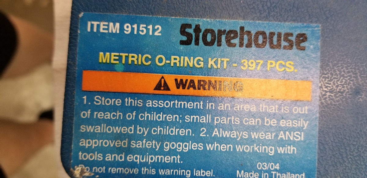

- tnpete
- Posts: 9
Re: KZP1000 carb pilot plug o-ring size?
14 Dec 2020 12:01
006 sure fits perfect. That metric o ring set I forgot about being in the toolbox. Had 24 of those in it. so at $8. each its saved me a lot of cash. LOL Not sure how long I have had it. Storehouse brand #91512

Actually, 006 is not metric, it's an SAE dash number size. Oh well, doesn't matter as long as you have some that fit.
