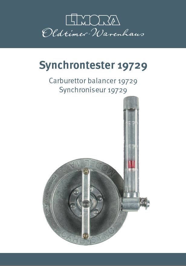

Hi, I was recently gifted with a Moto Meter Synchro-Test model 628.001.1000, its still in the box and in excellent condition, however it is missing instructions on how to use it, it is made in Leonberg, W. Germany, anybody here familiar with this synchroniser.

I've seen them before but never used one. You have to remove the airbox and/or air filter pods. Start the engine, set the idle to about 2000 rpm, then hold the foam piece against the back of each carb and note how high the vacuum indicator raises in the clear tube. The cone in the back provides restriction, which in part assures you have enough vacuum to get the vacuum indicator to raise. Think you are supposed to adjust the cone until you get the indicator somewhere up in the middle of the clear tube. Once the cone is set don't touch it again. Move from carb to carb and take note of which ones need adjustment and then go from there.
