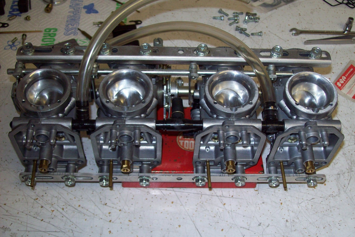

Never worked with any CR29's, but from the photos I looked at they have the same features as the CR33's that I have had on my bikes since back in 1982.
The two brackets that hold the carbs in place have elongated slots. These carbs can be made to fit numerous bikes just by sliding the carbs to different locations. Same with the throttle shaft that raises the slides. It also has extra drilled holes in case you have to move the slide arms that are connected to the throttle shaft. Once you get the carbs mounted to your motor, the only thing left is the jetting. The CR's are easy to change any part when it comes to rejetting!!!
You work off of carb #2 when you start spacing your carbs out to fit your motor. I took a set of CR33's that were set up for a 1000 Ninja motor, and I moved the carbs out to fit an early Kz1000 motor without buying one extra part!!!!!!!
You can see the slotted brackets in this photo real well
