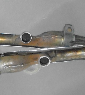

I'm working on brazing brass soft plugs into an exhaust system with the 4 into 2 balance tubes rotted. But have good solid metal on pipes to braze it to.
