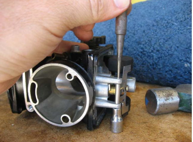

In the carb rebuild tutorial I linked it shows this photo on a specific method of removing a float pin for BS Mikuni carbs. I was hoping you would read this and apply a variation of this method to remove the pin on your carb. You may need to fabricate a support fixture that fits between the two posts so the upper post doesn't collapse when the pin is driven out. We can't tell you how to rebuild a carb we have never seen before but as you can easily learn from this thread, the huge majority of members here are KZ fans that tackle these problems by finding solutions to the mechanical problem, we don't give up and slap on aftermarket parts unless all other options are exhausted.
