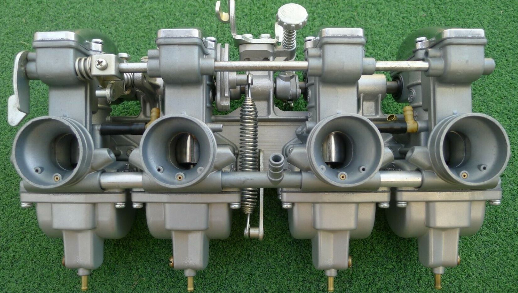

I recently finished up these carbs and it was a fun project. The TK's are a little more complicated than the more common Mikuni VM's but nothing overly difficult. I suggest taking lots of photos during disassembly and don't wait too long before putting them back together otherwise you may forget how they came apart (like I did.)
The choke sliders need some work otherwise the pins for the flapper valve may fall out. Loudhvx's webpages have lots of good info.
