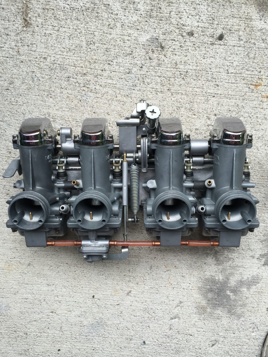

Carbs are done. The fat O-rings along with tightening the screws on the pump nozzle side of the float bowl before tightening up the other side sealed up that area nicely.

They look nice! What bike did they come from? Mine have two fuel inlets (no crossover in the middle) with the adjuster on the top.

Sorry, but I don't know what bike these came from. They were purchased off ebay with the intension of fixing and flipping for beer money. The parts fishe suggests '79 or '80 1000 A3/A3A and I think A4
