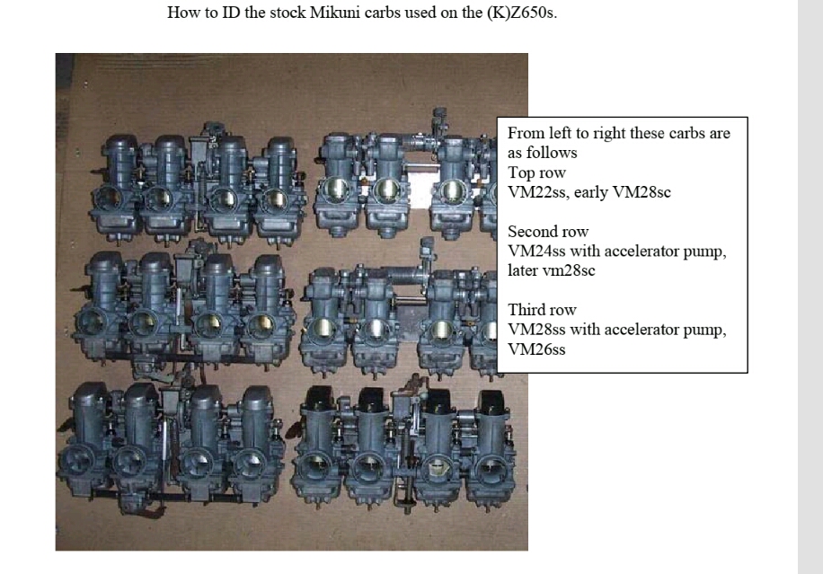

If they look similar to the 24's maybe they swapped in VM26SS. Post pictures please.

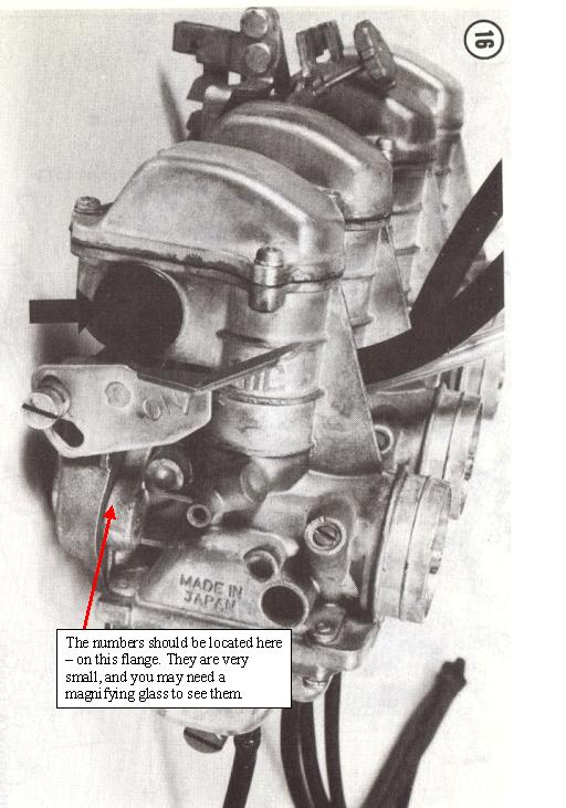

Pictures of your carbs may help us to ID the carbs. There should also be an ID stamped on the flange below the choke lever or on the outside of carb number 4. (Carbs are numbered from 1 to 4 left to right as you sit on the bike. ) If you would post the ID stamped on the carbs it might help us to provide what the carbs are.
