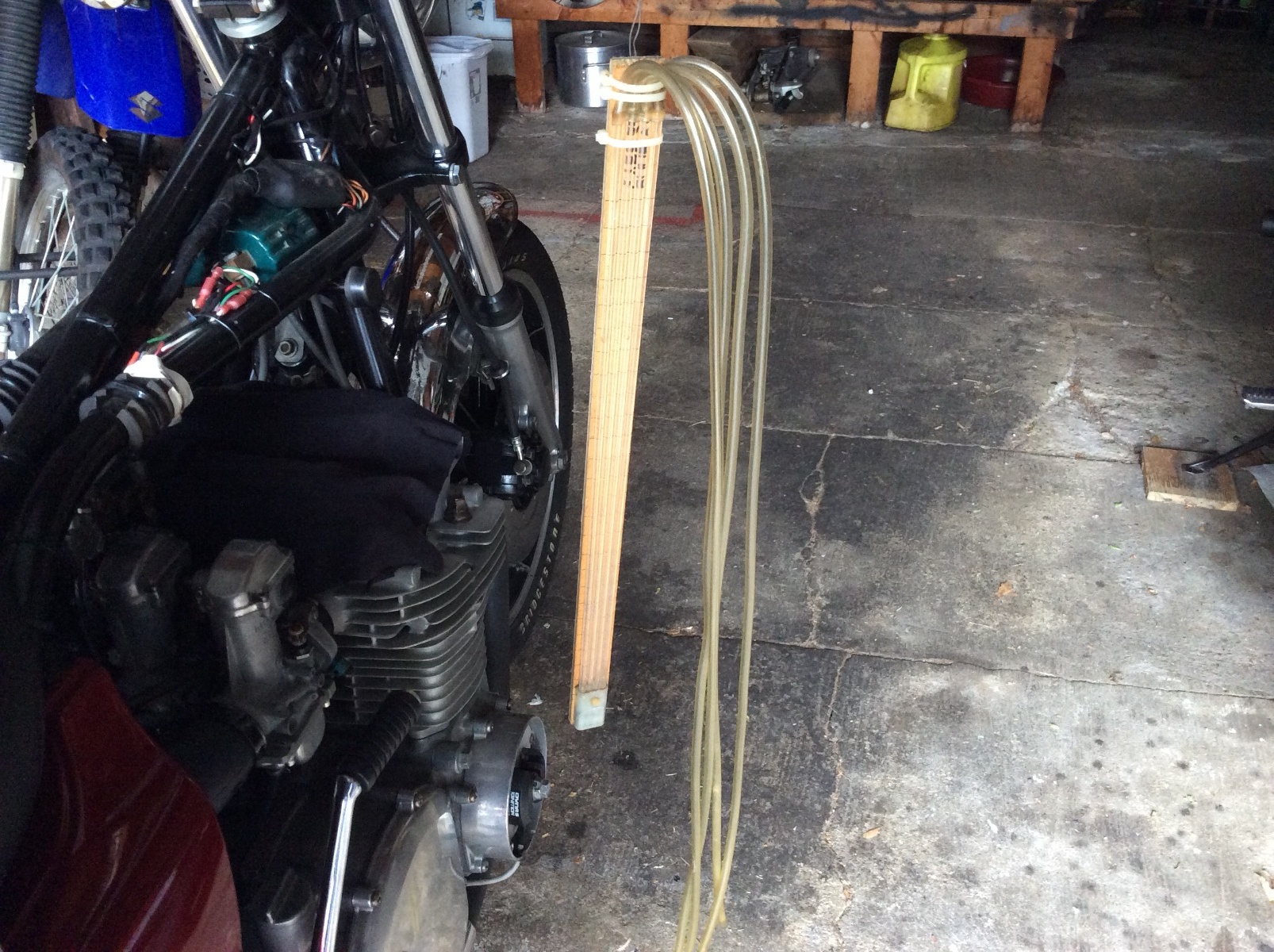

I've used an 8' section of clear tubing in a u-bend and some water.
I let the twin cylinder play tug of war with the water column. It's very touchy with the pulsations and no restrictors but it will do in a pinch.

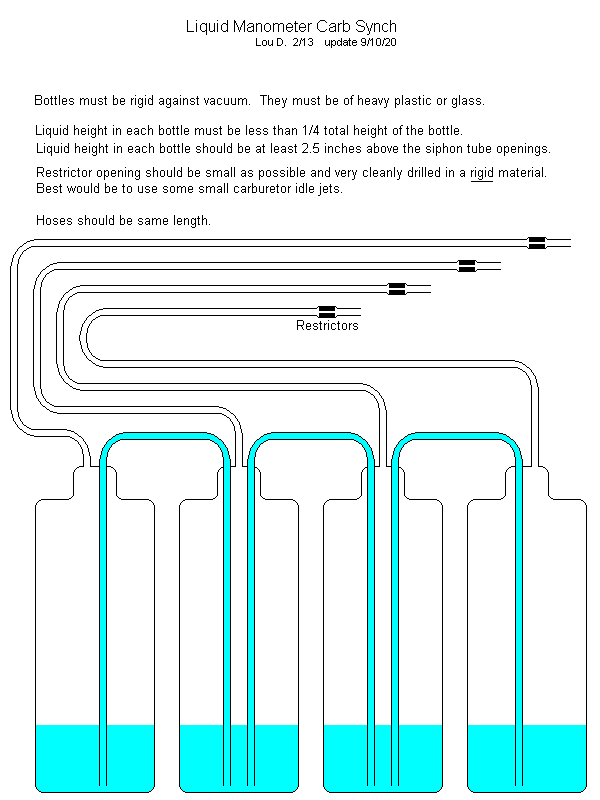

I'm sure I've posted this before, but here's one for a 4-cylinder using water that is self-priming and won't suck water into the engine.
It must be super heavy plastic or glass. Thin plastic will collapse instantly.
The only issue is that it will be touchy. Water is much lighter than mercury. So if you get the water to stay in all four bottles, you will probably close enough to a really good sync, even if the water levels are not exactly the same.
I haven't built it , but it shouldn't be too hard to get the parts from a science supplier.

13 Sep 2020 12:51loudhvx wrote: I'm sure I've posted this before, but here's one for a 4-cylinder using water that is self-priming and won't suck water into the engine.
I think two stroke oil or leftover fork oil are better choices than water. They are easier to see and a bit less watery.
