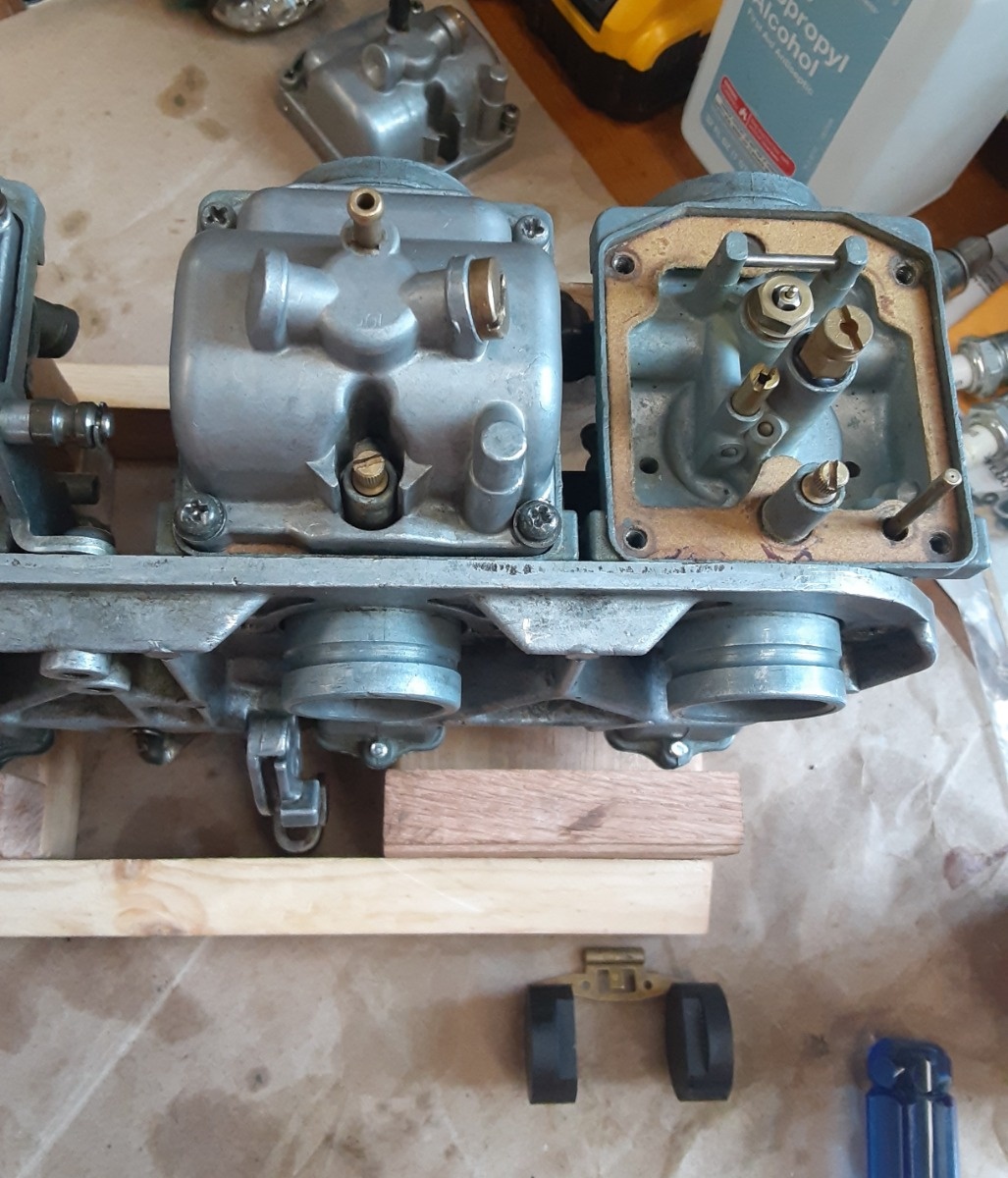

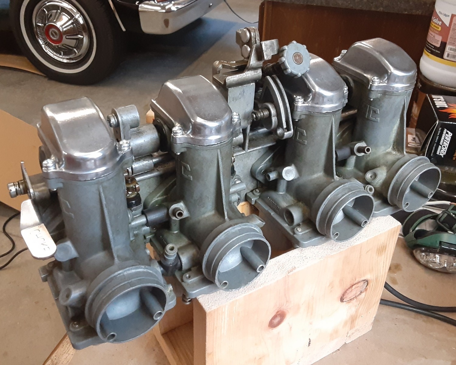

A2 carbs will have a brass vacuum take off stub on number three carb for vacuum operated petcock, so if they are, numbers 1, 3 and 4 will have stubs 1 and 4 are breathers and 3 the vacuum, A2a carbs will have an accelerator pump system on them, A1 carbs will not have vacuum stubs, pictures of the rear and underneath of your carbs will help us make a better identification.
The following user(s) said Thank You: Scirocco, hardrockminer, tmeric7
- tmeric7
- Posts: 12
- Thanks: 2
Re: more things I don't know about carbs: VM26SS
09 Sep 2020 10:21
Thanks!
kevski,
There is no brass stub on #3 for petcock vacuum. There are brass stubs on #2 and #4 for breathers. Here is the rear.
And here is underneath.
I'm not sure from your comment if A1 has no stubs "at all," but there is nothing for petcock vacuum and the 2 present were previously breathers.
Everything else I see is consistent with A1, except for the main jet, which is 110, closer to A1 (107.5) than A2 (105). Also, P/N's 42, 43, 44, and 45 below are identified for "late 1977 on" in Clymer. Mine does not have them.

kevski,
This leaves me with one question at this point... The petcock is vacuum activated, and I scratched my head for a second trying to remember where that comes from, because it has not been assembled in a while. It must be that the petcock vacuum hose is attached to the port on the bottom of the rubber "holder" between carb #2 and the engine, P/N 28 in the image below. It has been missing the rubber plug, and I forgot why. Is the a common/acceptable way to draw vacuum to operate the petcock?
