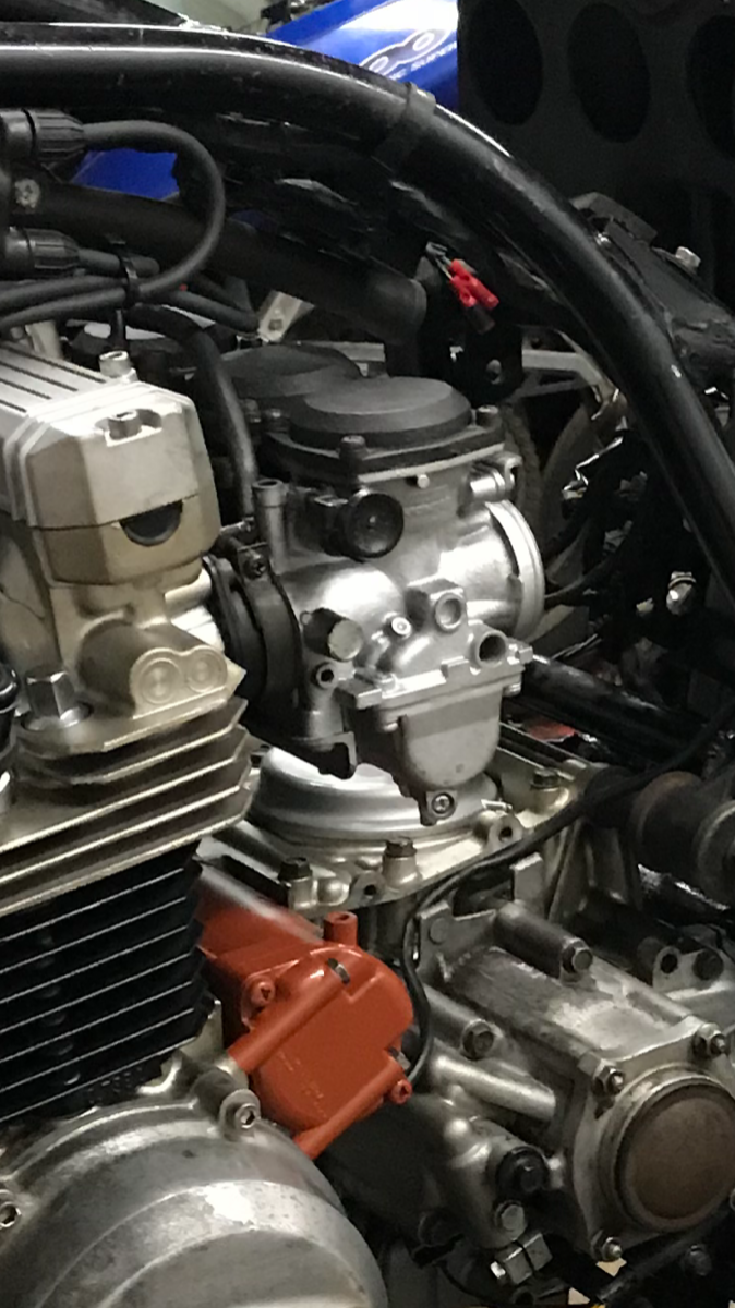

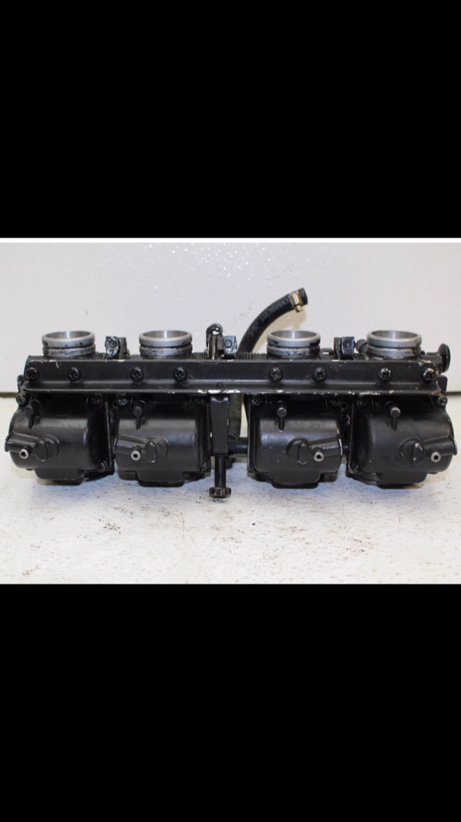

Hi, I have a kz750N1 spectre 1982 which originally would have been fitted with Keihin CV34 carbs, I’ve had it for about 8years and all this time it has been fitted with Mikuni carbs, I’ve never been able to find out what these carbs came off but they are in poor condition with some internal amateur modifications, I’ve been looking for a set of carbs for a while and have finally purchased a set off a kz1100 spectre 1982 which are Mikuni BS34, does anyone know if these will fit as in dimension wise ? I intend having them professionally stripped and cleaned and Set up for a 750 engine. Thanks

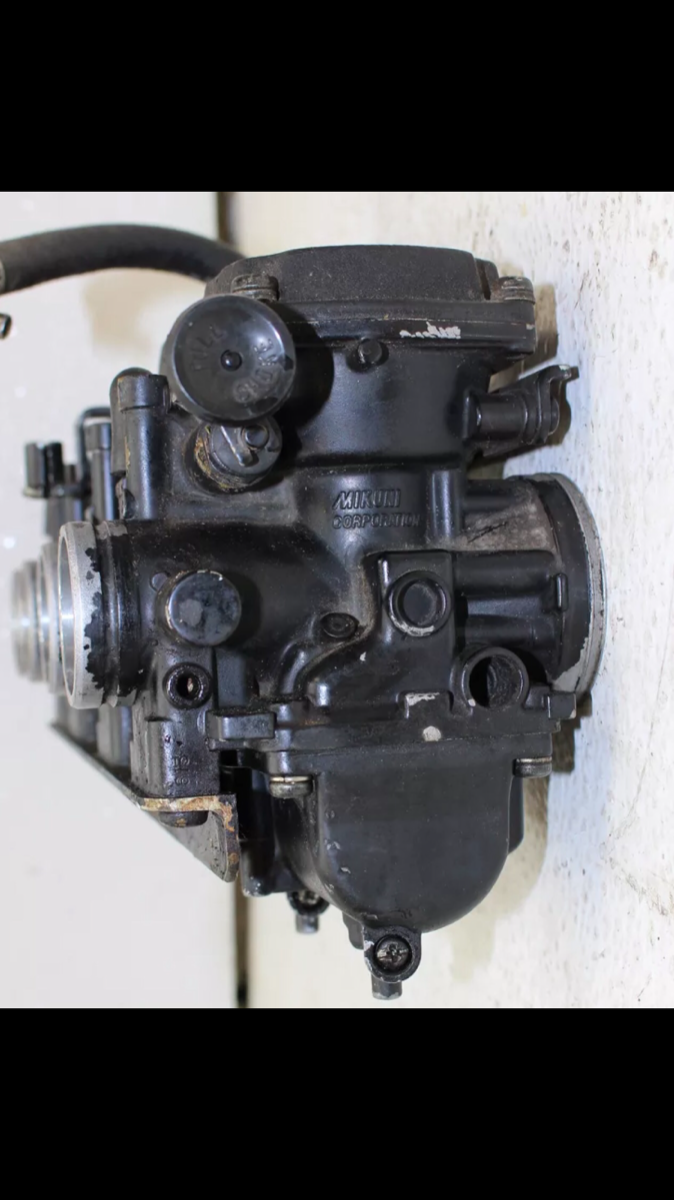

Some pictures of the carbs may make it easier to identify them.

Re: Carbs

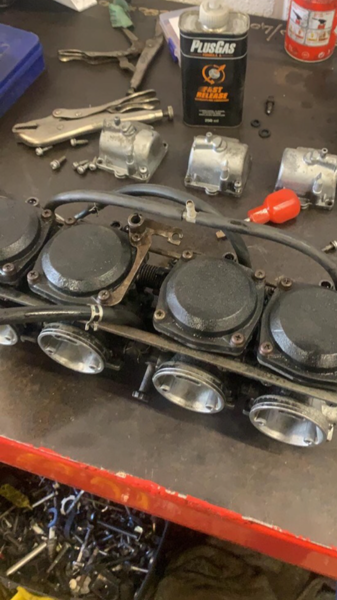

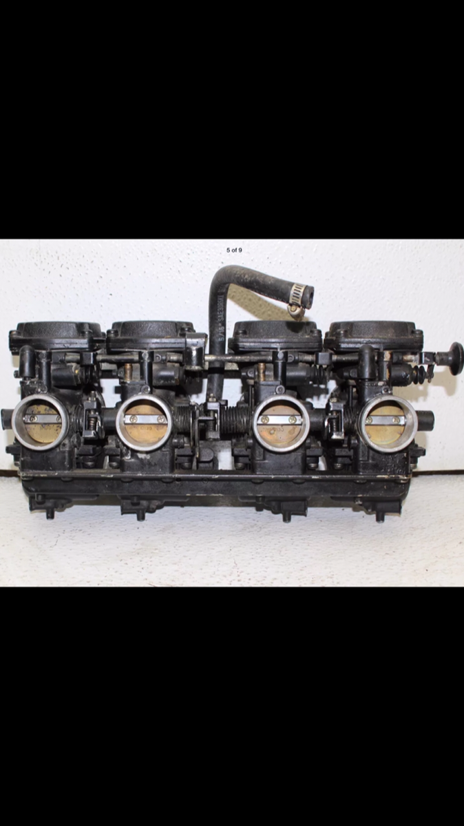

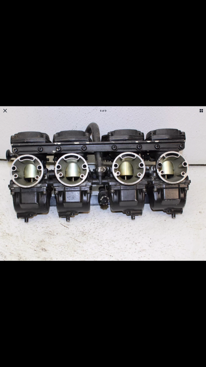

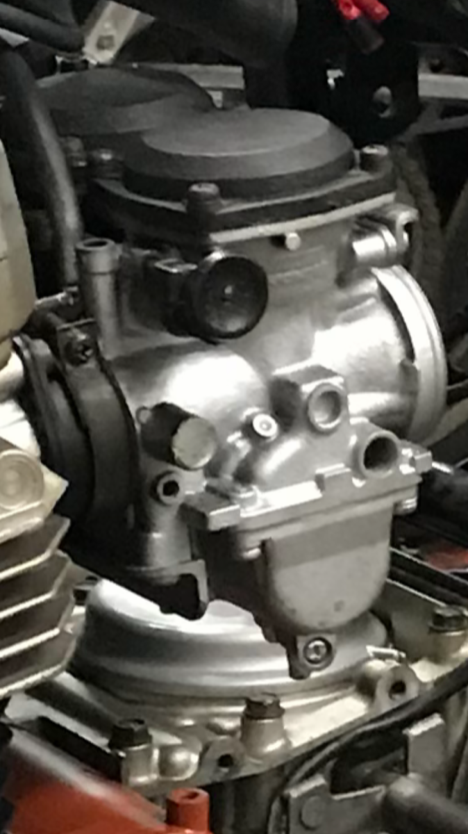

27 Aug 2020 16:32 - 27 Aug 2020 16:33
Hi, the top three pics are the unknown carbs on my bike and the bottom three are the kz1100 spectre Mikuni BS34.

Re: Carbs
27 Aug 2020 17:08
The carbs on your bike look like the bs34 carbs from a gpz750. I would imagine that a set off a gpz750 ( that the PO didnt tamper with) would be better suited for your 750 than a set off a larger bike.
Those are the carburetors i am running on my 810. I haven't experimented with different carburetors on that bike, but they've been great and havnt given me any issues in the 10 or so years since i built the bike.

Re: Carbs
28 Aug 2020 03:31
These look very much alike- first picture are the carbs that have been on my bike since I’ve had it and the other picture is of the Mikuni carbs off the donor bike KZ1100 spectre.
