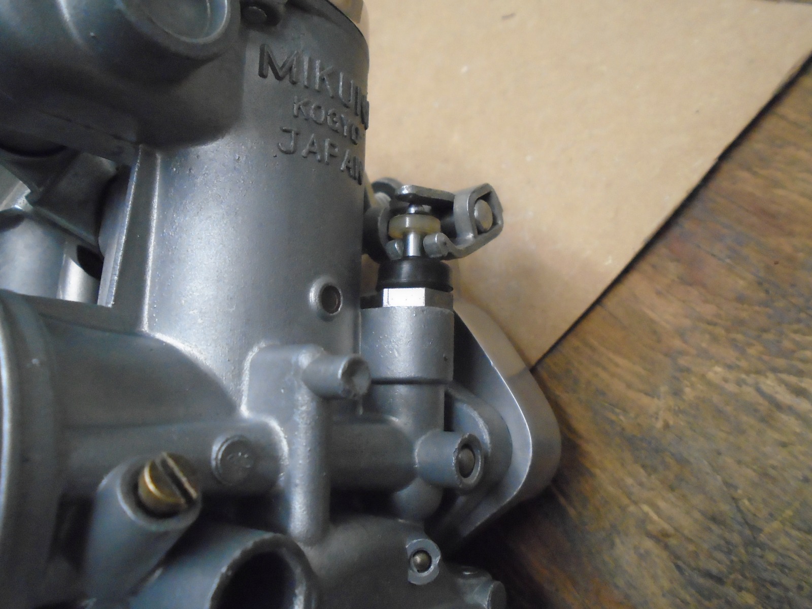

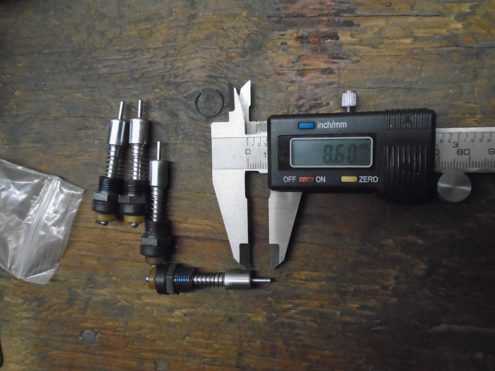

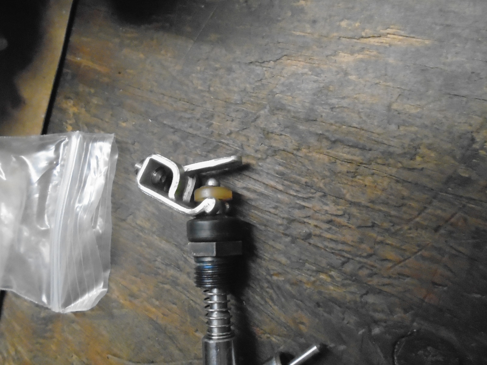

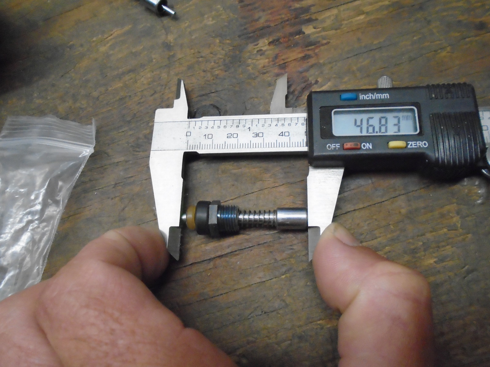

Good Morning Fellas! Finishing-up a set of the Late 73 Z style carbs and found out all i had for Choke Plunger selection was a set of the Ribless Plungers. They are about 3mm shorter so the lifter prematurely holds the plunger in the Choke On position. Anyone have a set or trade for these earliest of the early style plungers? I don't need these , sold the last set of ribless before the "new normal" began. Hope everyone is Well and staying Busy!! Clay

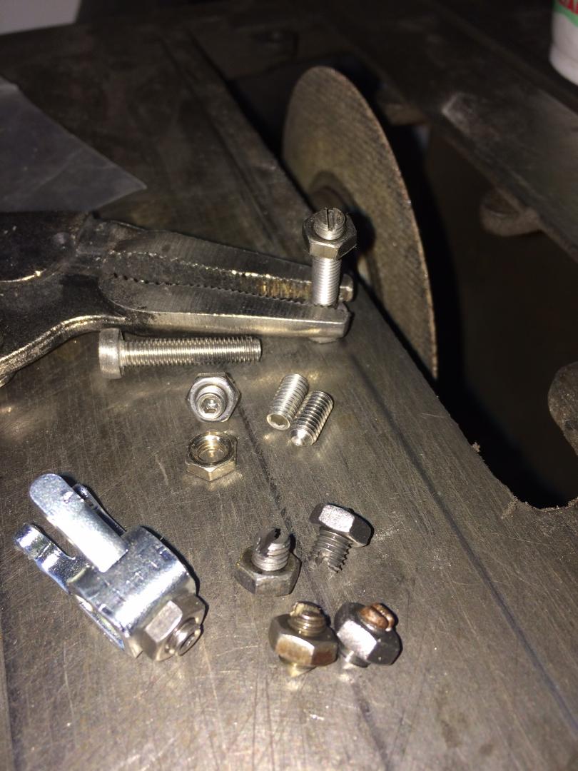

Hey A', I could use those plungers. I need a set of those white plastic lifters. I know about the new world! Your lucky if you sold before for big $$. I procrastinated, I had a set of 1470's to finish last November. Had zinc plating done. Now They might be a few hundred dollars less on the re-sale market. Looks like nice work you do! Did you see the stainless linkage pieces that I made double thickness? I sold about 18 sets of them to the world. And for those small set screws for the early choke plungers I just used set screws and made thin jam nuts. Just chiming in I need these ones. I am just trying to find the small nylon pieces.

Try the Paint remover trick Zed, no scrapping or digging. Just sit them in a glob of paint remover overnight. I remember paying about 500.00USD for set-up and got i think 500? I used to have a box of them in a sealed bag but still cannot find them since the move?? Z1kzonly, I still need the plastic rings, Sorry!! I use the SS set/grub screws also except on the visible one. Yep, Dremel a slot in a SS screw, ha. I bought a bunch of the OEM SS linkage connectors years ago and don't need any at this time but Nice Work. Its all in the details. I still have a couple re-plated hardware/ bracket/choke rod (with nice Plastic) assemblies sitting around somewhere. And a couple 74 and 75 early 28's floating around here somewhere also?
