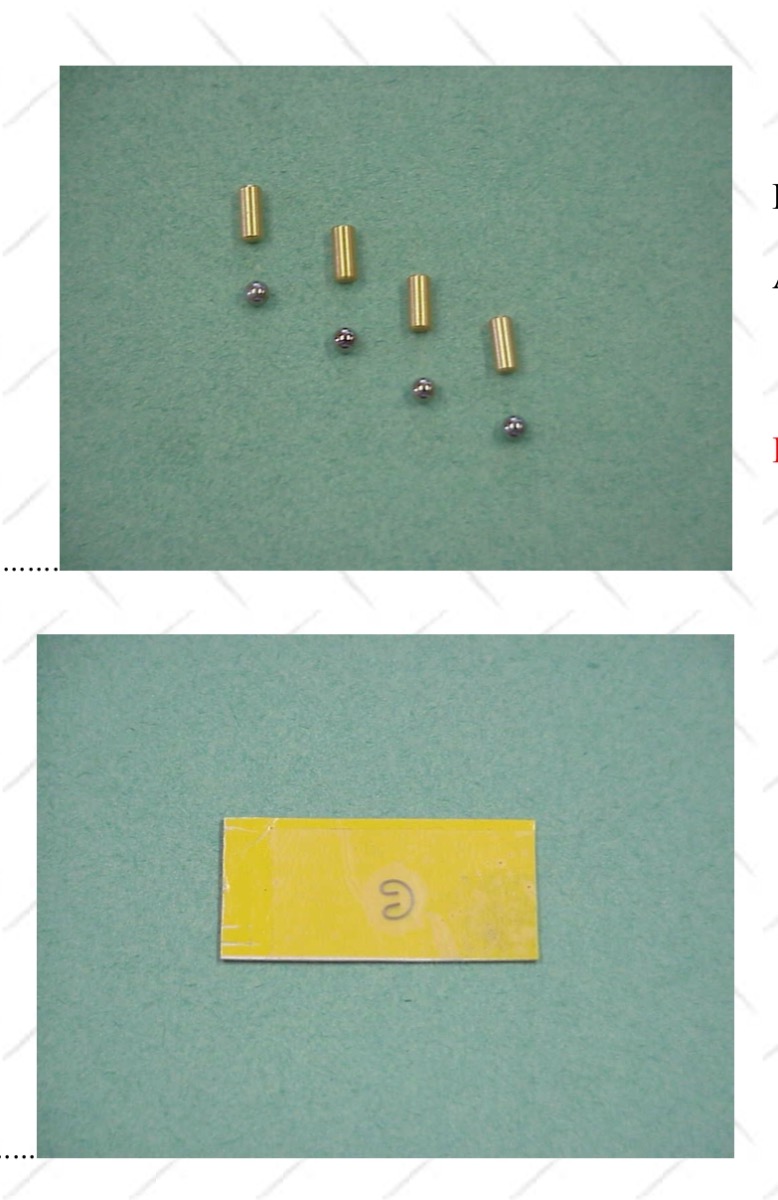

I was soaking my kzs carbs in carb cleaner and when I pulled em out I found a little bb or like a ball bearing. I have no idea where it goes, does anyone know?

It’s a check ball. A small brass cylinder sits on top of it and held in place with a small clip. It goes in the fuel bowl at the front (filter side) See photo of parts

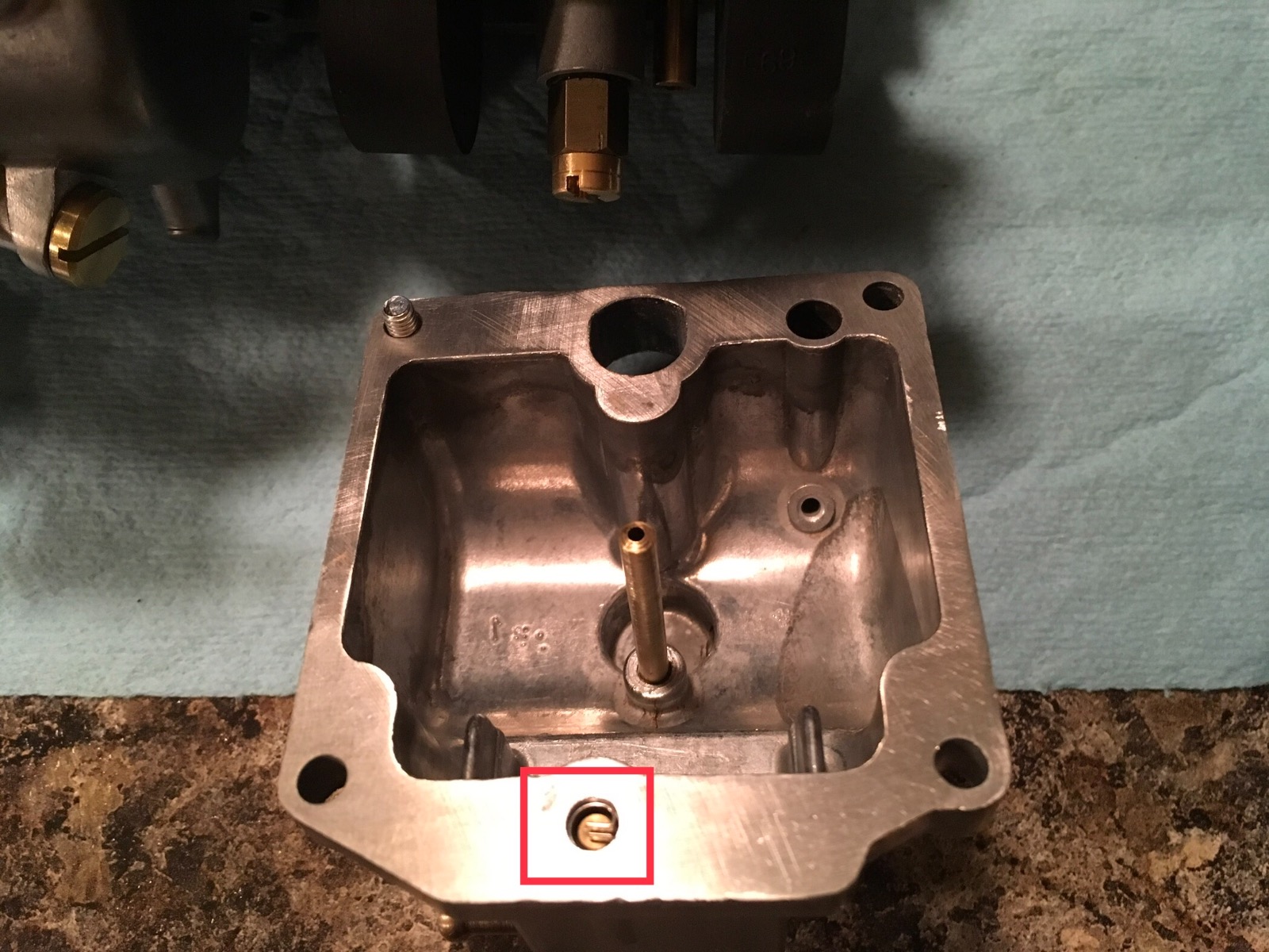

See red square for place in bowl where those parts go
