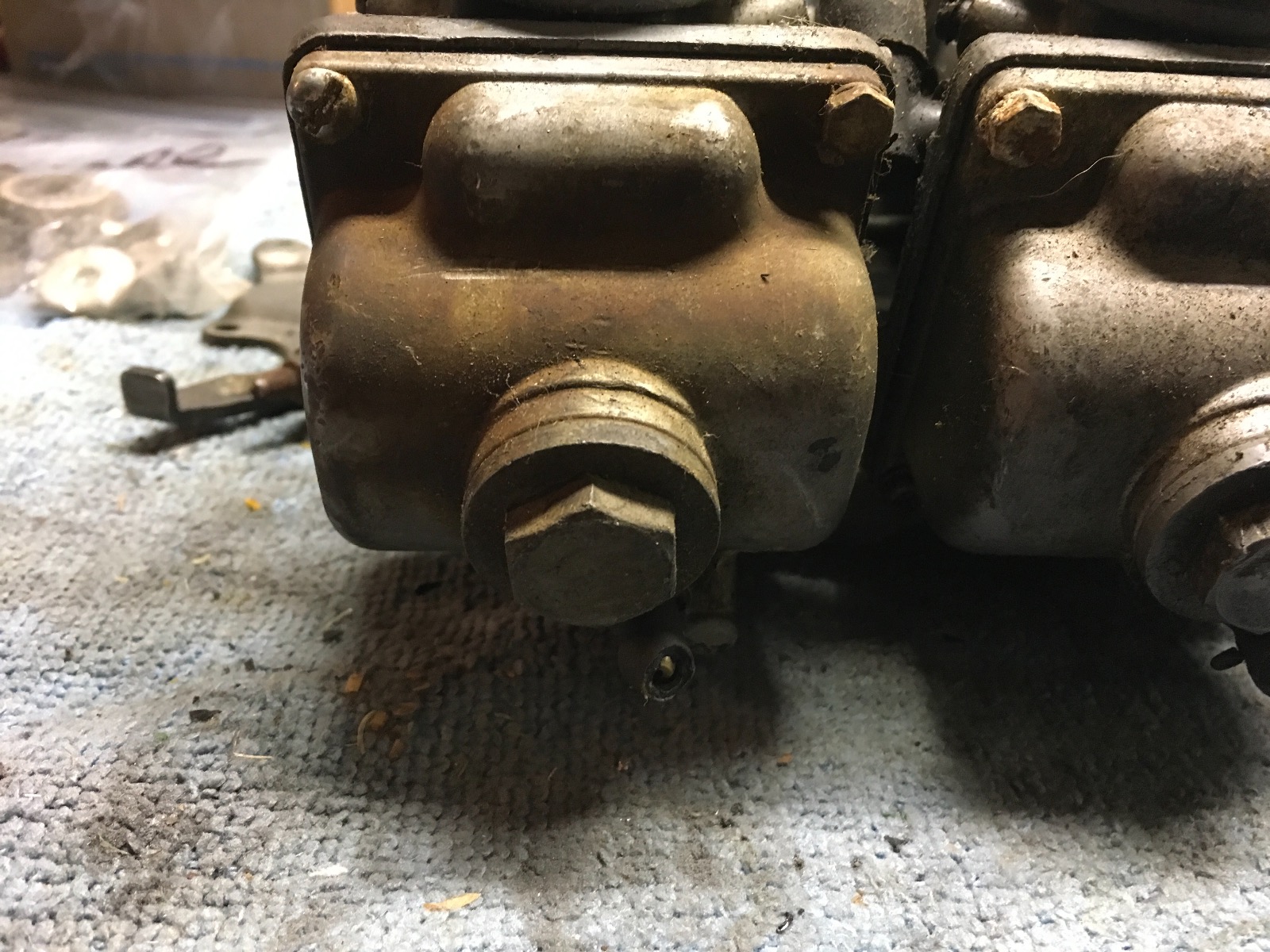

Guys, anyone know the thread size for 73 z1 vm28 bowl drain screws? The ones with th big drain screw at the bottom of the bowl?
I need to sort one for tomorrow so its make one time.

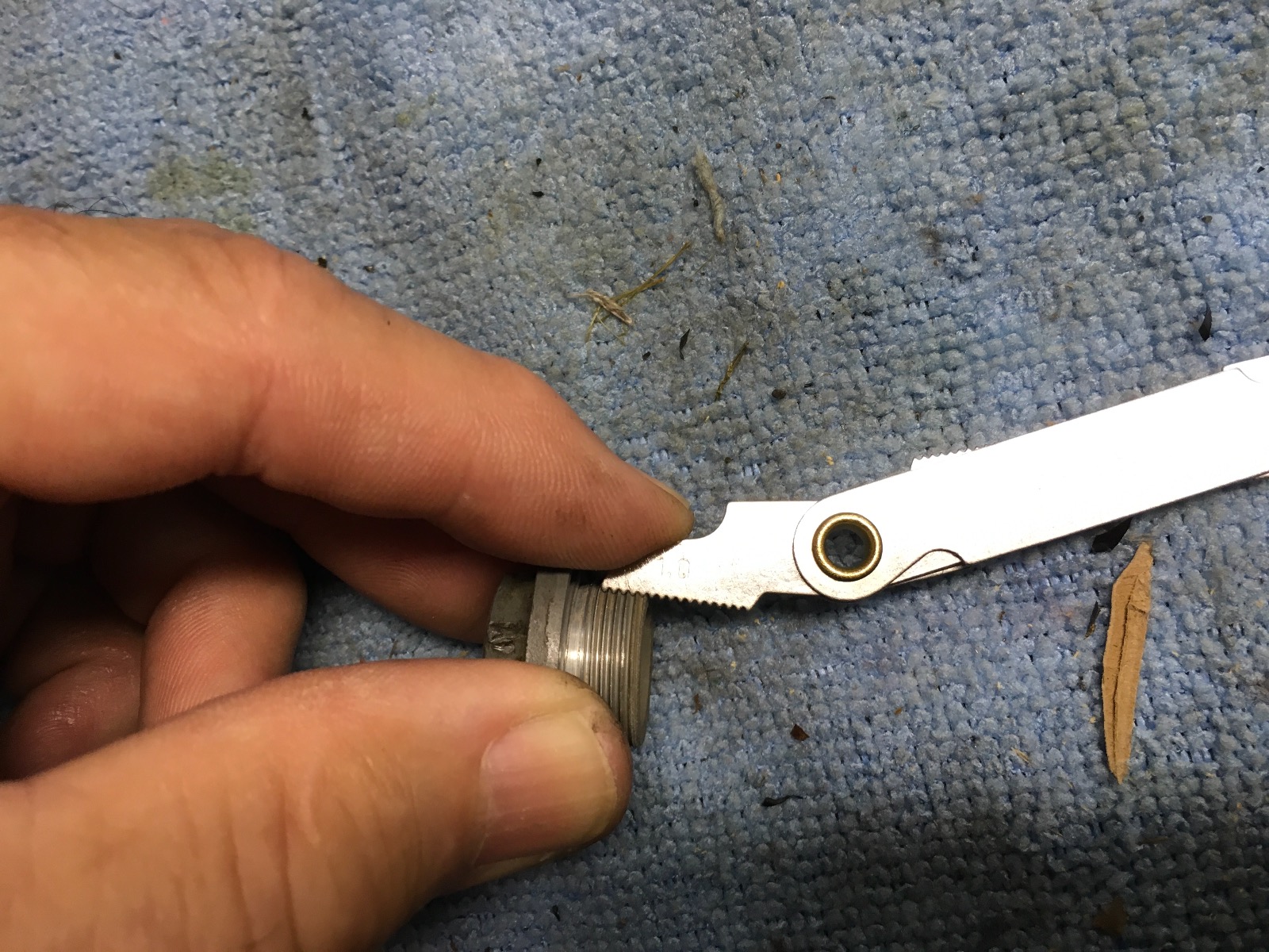

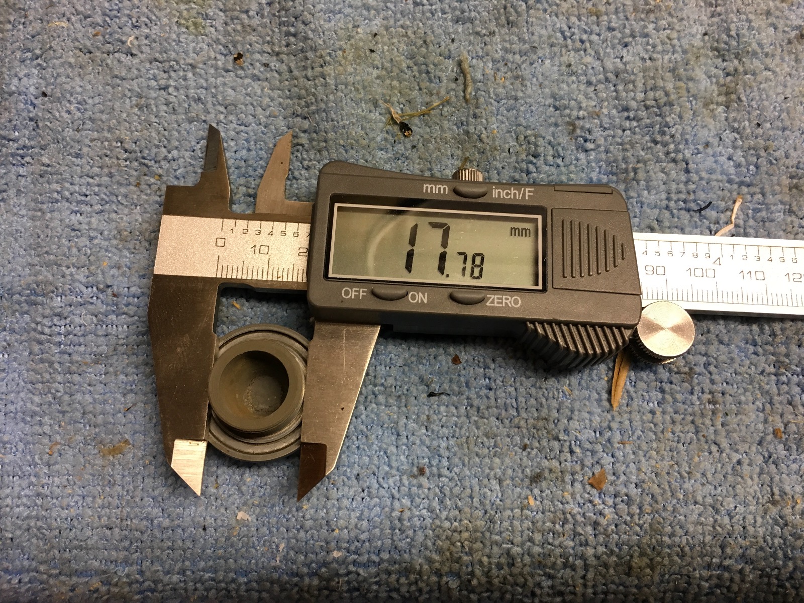

I have a set on the bench. How do I measure for you

18mm with a 1.0 pitch?

Pefect Mikaw, thank you very much. Exactly what I needed.
