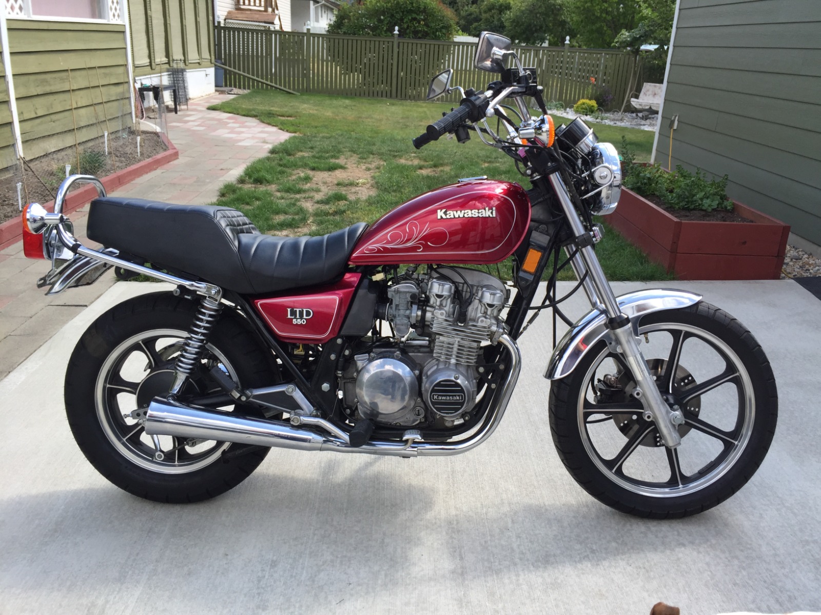

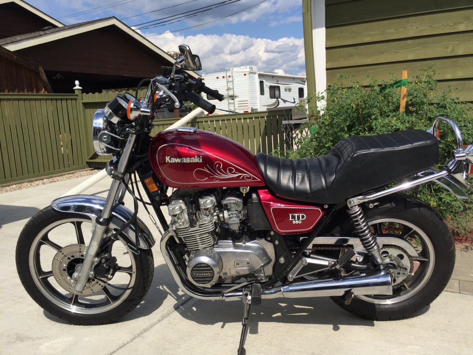

Just to finish this off....I finished installing everything and checked the carb boots for any air leaks. There were a couple so I waited til the bike was hot and tightened until I couldn't any more. Still a small leak on #2 carb but not a lot, so I vacuum synched the carbs. They were close from the mech synch...I only had to adjust one a half turn or so. The bike isn't insured this year but I took it out for a around the block to see how it runs. It's rough to warm up, as usual, but once warmed up it's very stable. It responds well to throttle, but I need to adjust the cables a bit. The throttle seems to stick at a high idle, revving about 3000 when coming to a stop, until it is twisted back to idle position. The KZ 550 is a very nice bike for a smaller rider but it's a bit too small for me, as you can see from the photo.

Very clean!!
