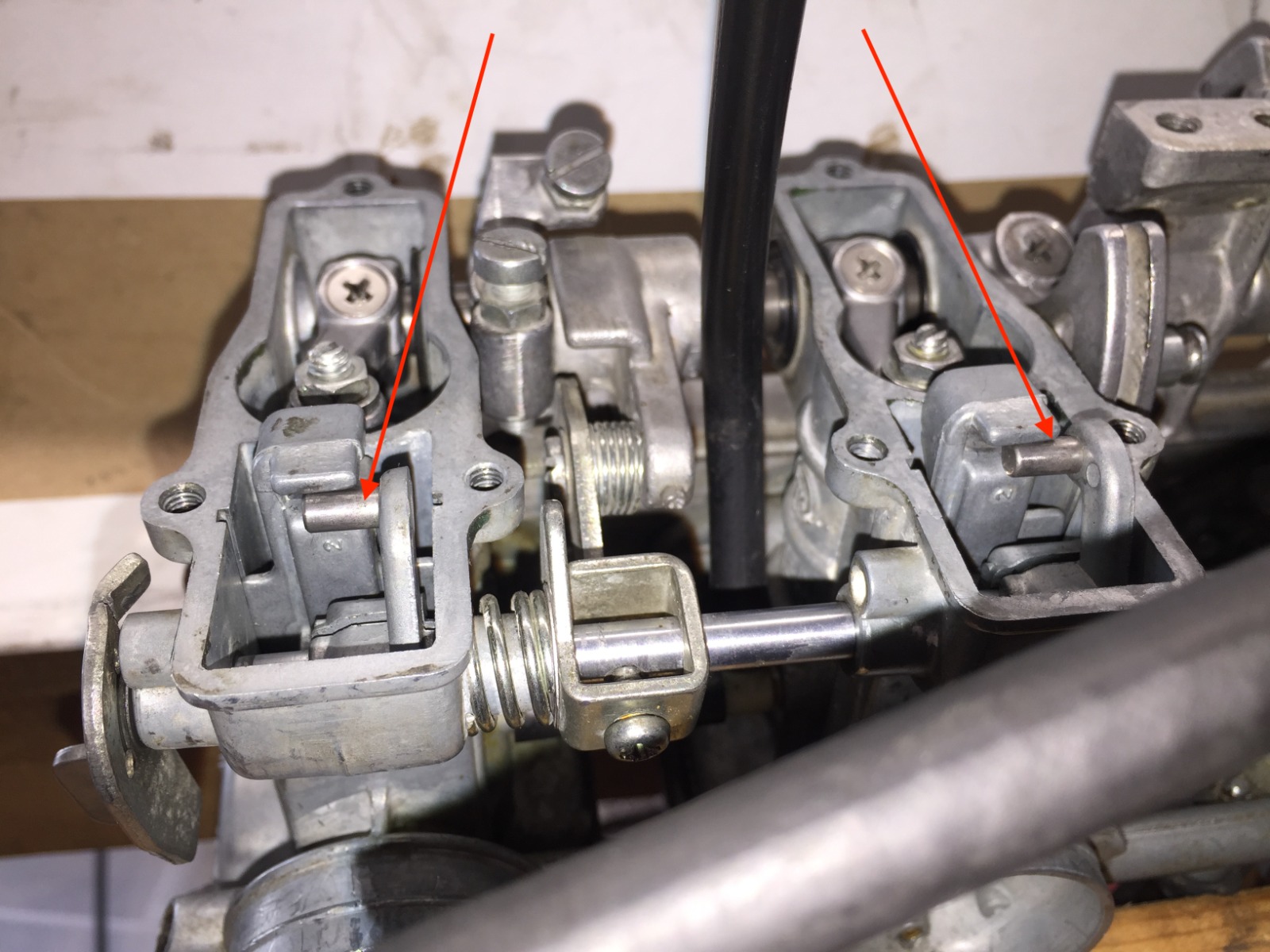

I finally got around to pulling the carbs off the bike. The air hose was fine...no blockage. But I found something interesting. All four of the choke valves had slipped out of the slot holding them. The choke lever is over-rotating past vertical, and this is what allows the choke valves to slip out.
I'm trying to figure out how to fix this problem. Has this happened to anyone else?

Re: TK 22 carbs on a 1981 KZ550 LTD. (C2)
31 Aug 2020 16:13
Does that happen when the covers are installed?
31 Aug 2020 17:41
Yes, I noted the bend but there is no stop on the lever so I don't think it's a problem. There is a little ball behind the lever and two indents on the inside that correspond to full choke and no choke. The lever seems to be a bit too far from the ball for it to sit in the indents correctly. Not sure why. I tried to remove the lever and rotating arm but it seems to be fixed in position.
Yes, I think it was occurring with the tops on, but not positive. I will check that when I go back at it tomorrow. I was trying to do a mech synch and having some issues so I gave up for the night.
31 Aug 2020 20:23
Someone probably bent it as a shortcut to remove the choke plates in order to maintain the choke flaps. The proper way is to remove the screw on the bell crank.
