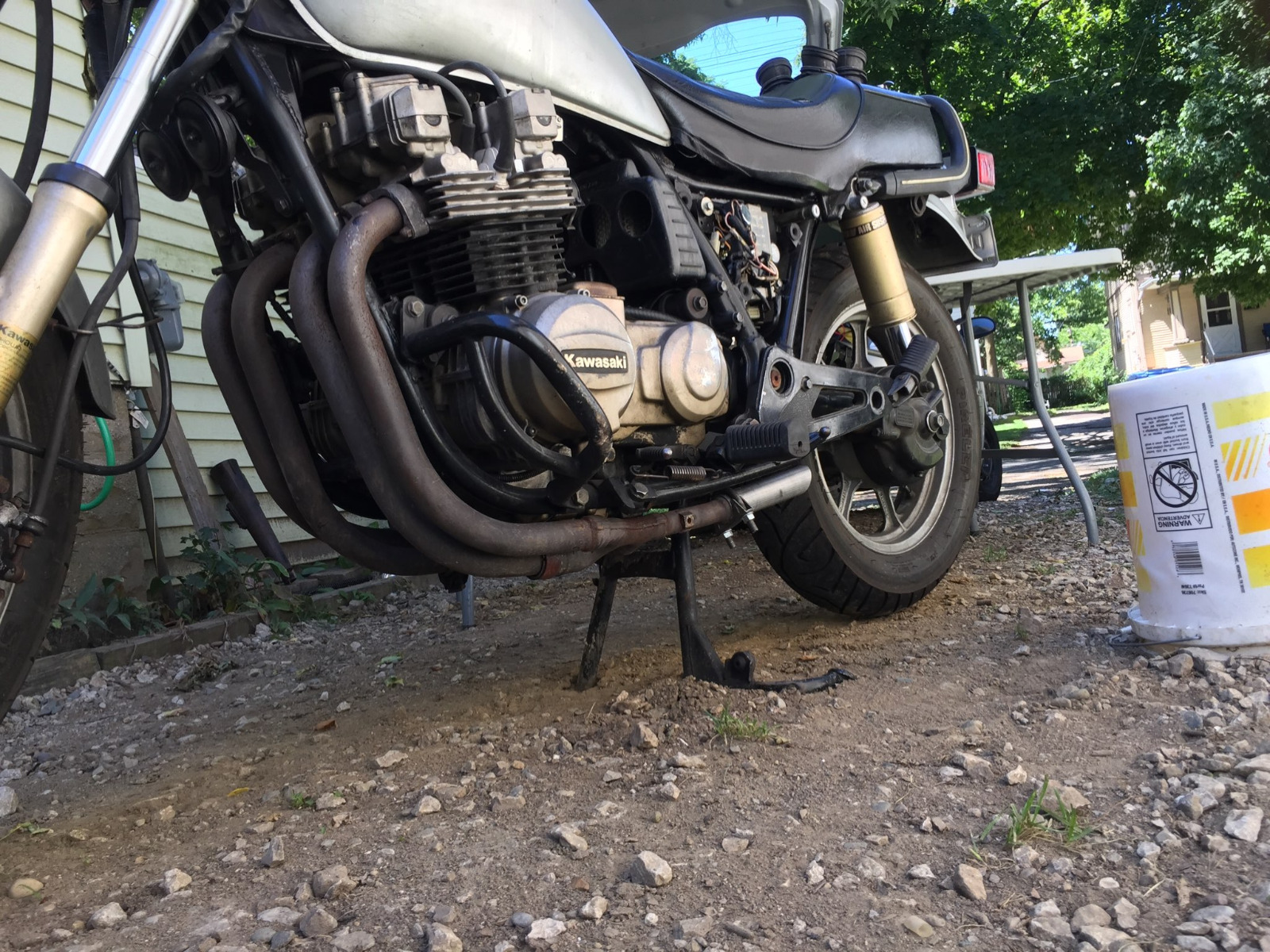

I'm using BS34s. I'll start with a chronological list of things that I've tweaked.
-Changed main jets from 115 to 117.5; seemed to pull for longer (pulled until about 7.3k instead of 6.5)
-Went to open headers with 6" slash cut tips I made. I know this complicates things, but I like the sound. Didn't help, obviously, and ran very lean.
-Changed pilot from 37.5 to 40, main from 117.5 to 122.5, 2 shims added below stock needle clip, sync'd and timed. Pulls nicely until 8,000, then not much.
Before spending another $20 on 125 mains, I'm wondering if this could be an issue of restriction (stock headers, stock airbox, stock filter). It's great to ride in the first 8,000 RPM, but I paid for the whole tachometer, so...I'd like more. I'm fairly certain that fuel flow isn't a problem, as I can do several 0-50 pulls in first in rapid succession without starvation. I'm curious about pod filters or velocity stacks, but I'd love to sort this before going that route.
Your input is, as always, appreciated, and please enjoy this pic of my handiwork for your time. I truly have mastered the art of exhaust fabrication.
