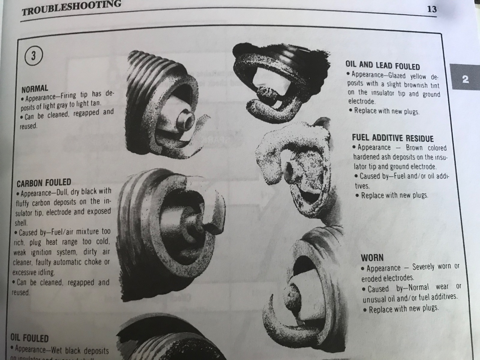

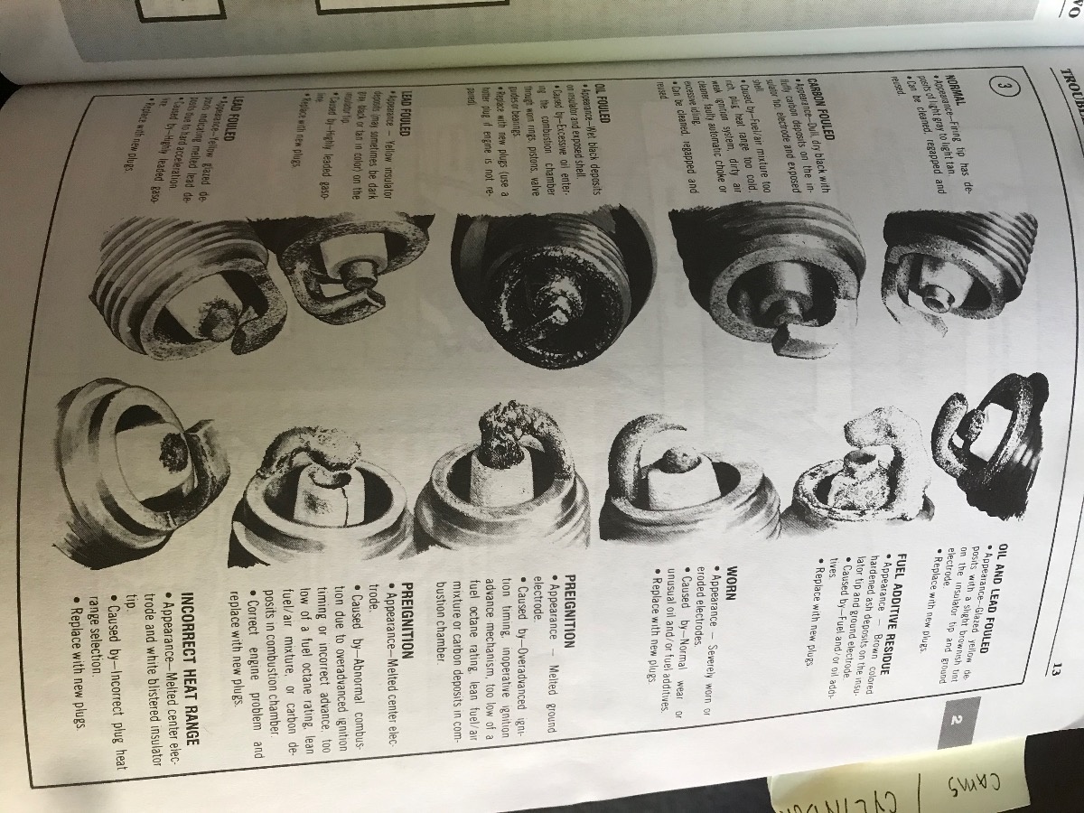

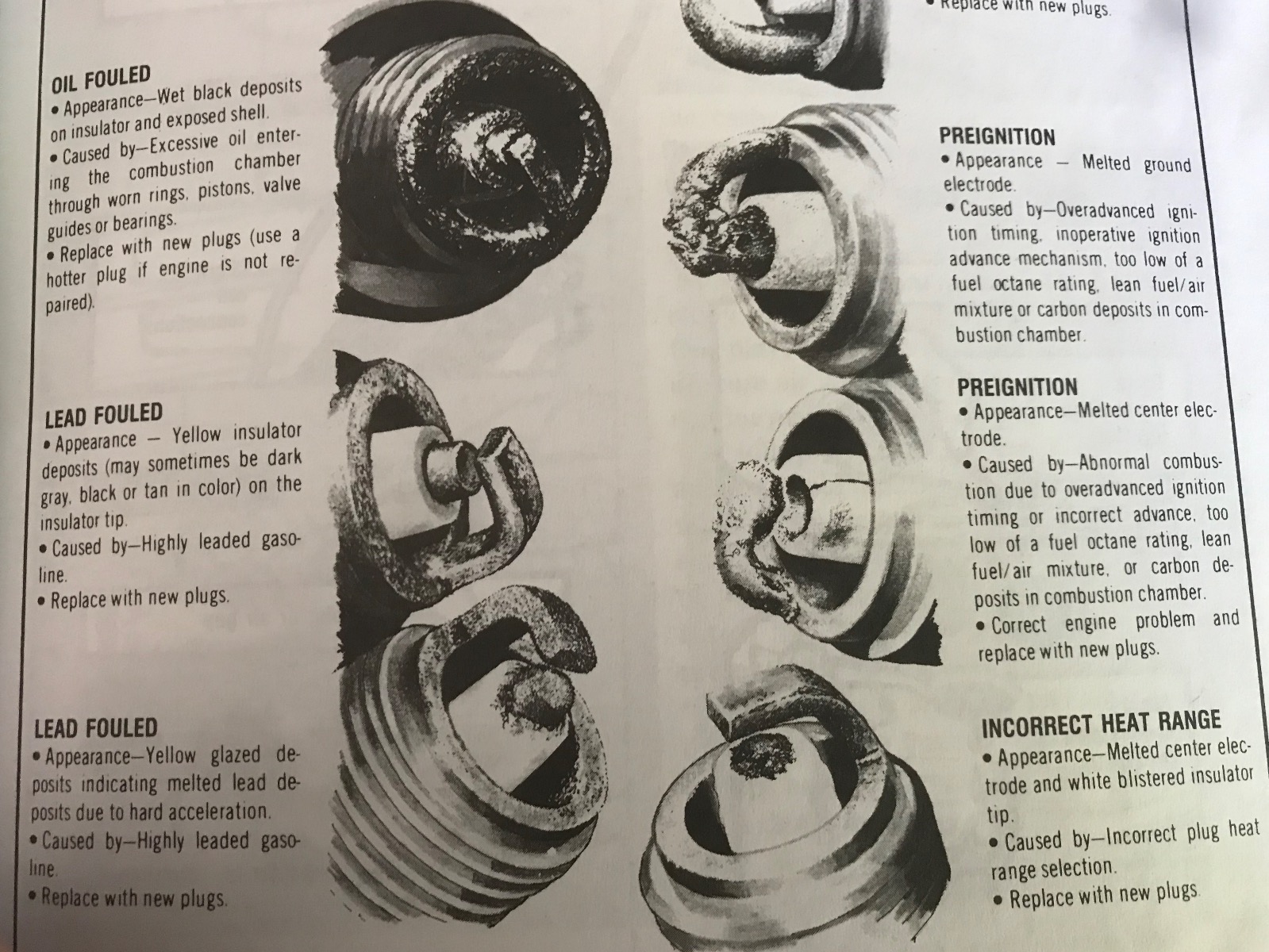

Welcome.
And good luck. There’s some great information and folks here, and a great searchable trove of past posts and tips.
I’m no diagnostic expert, but here’s a couple pictures from a manual for generic spark plug symptoms;

Thanks for the information and posts on this topic, my first to the forum. The detailed off carb procedure is excellent information. The photos of the spark plug are useful as well.
