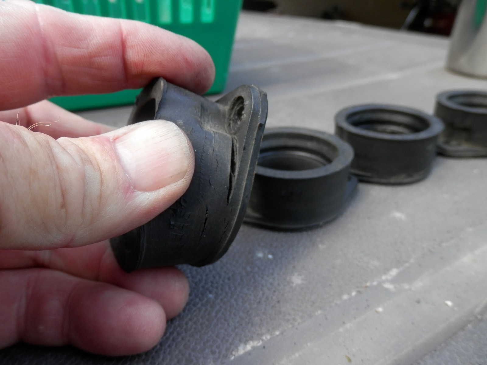

Spit back through carb when warming up and at low rpm on my 750 was caused by cracks in these thingies
Not always obvious but easy to spot if checked carefully.
They dont last forever. I have replaced them twice in 17 years
