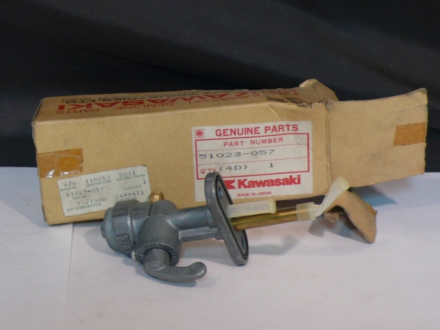

I've been in this situation with my kz1000st ,firstly it does sound like the vacuum part of the fuel tap isn't doing its job, honestly forget the nice and cheap fuel tap rebuild kits out there, I tried two and you can rebuild them as carefully as you like under a magnifying glass with tweezers and they'll either let fuel through or shut it off too much, my advice is do what ever it takes to find a complete new old stock tap and pay what you have to pay then fit and forget, my tap came from Germany when I tracked one down and it cost £85 .

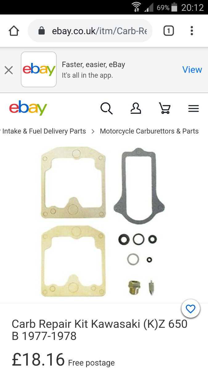

oh in the carb kit pic you just want the two little bits bottom right, you can fit the other parts of the kit if you like but the main thing is the needle valve

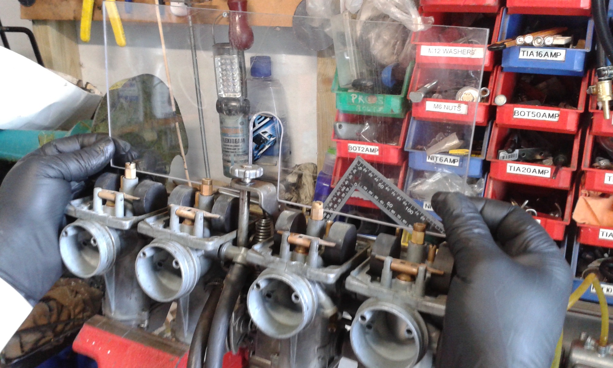

If you want an easy method to check your floats....read this link carefully.
www.kzrider.com/forum/forum-index/3-carb...n-setting-fuel-level
The following user(s) said Thank You: slmjim+Z1BEBE, Price
