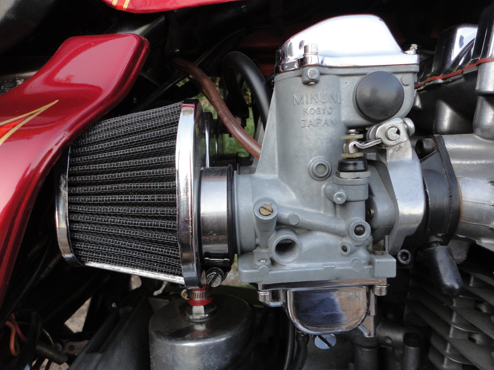

- ckahleer
- Posts: 540
- Thanks: 193
Re: Ultrasonic cleaning carbs (aluminum)
14 Jul 2020 19:00
The carb bowl and body matched before ultrasonic cleaning the body. The bowl was cleaned in the deep sink with Orange Goop hand cleaner and a tooth brush.
1997 ZL600
94 KE100
82 KZ305
74 TC185
94 KE100
82 KZ305
74 TC185
- krazee1
- Posts: 365
- Thanks: 215
14 Jul 2020 19:20
Orange Goop has a mild abrasive in it, you basically polished the float bowl, ultrasonic cleaners don't polish. Vibratory cleaners can polish depending upon the media, but media can also get into places where you don't want it.(don't ask how I know!)
