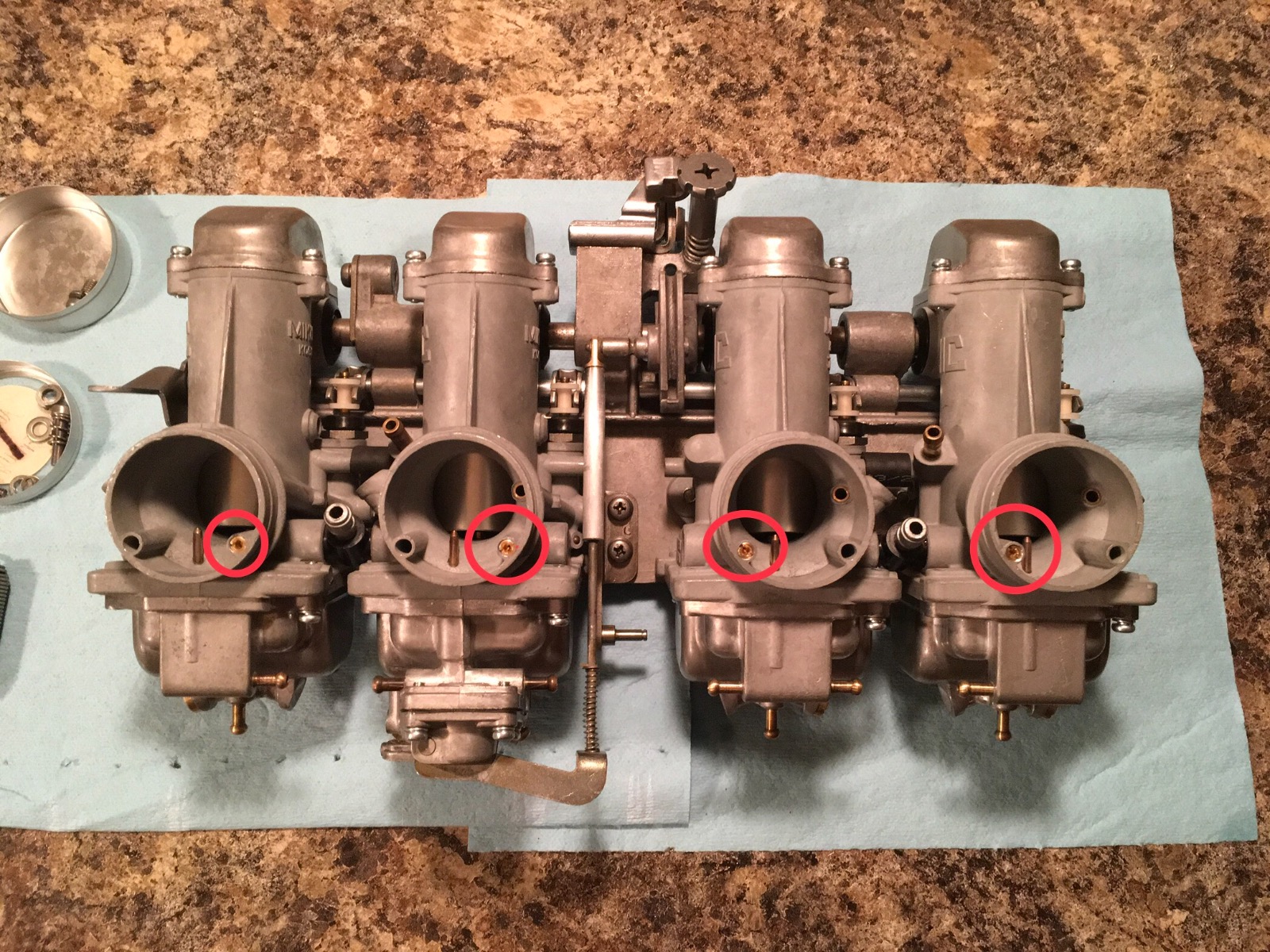

To identify whether you have smoothbores look for the circled square casting as shown in the attached pic.
If this is not there they are not smoothbores.

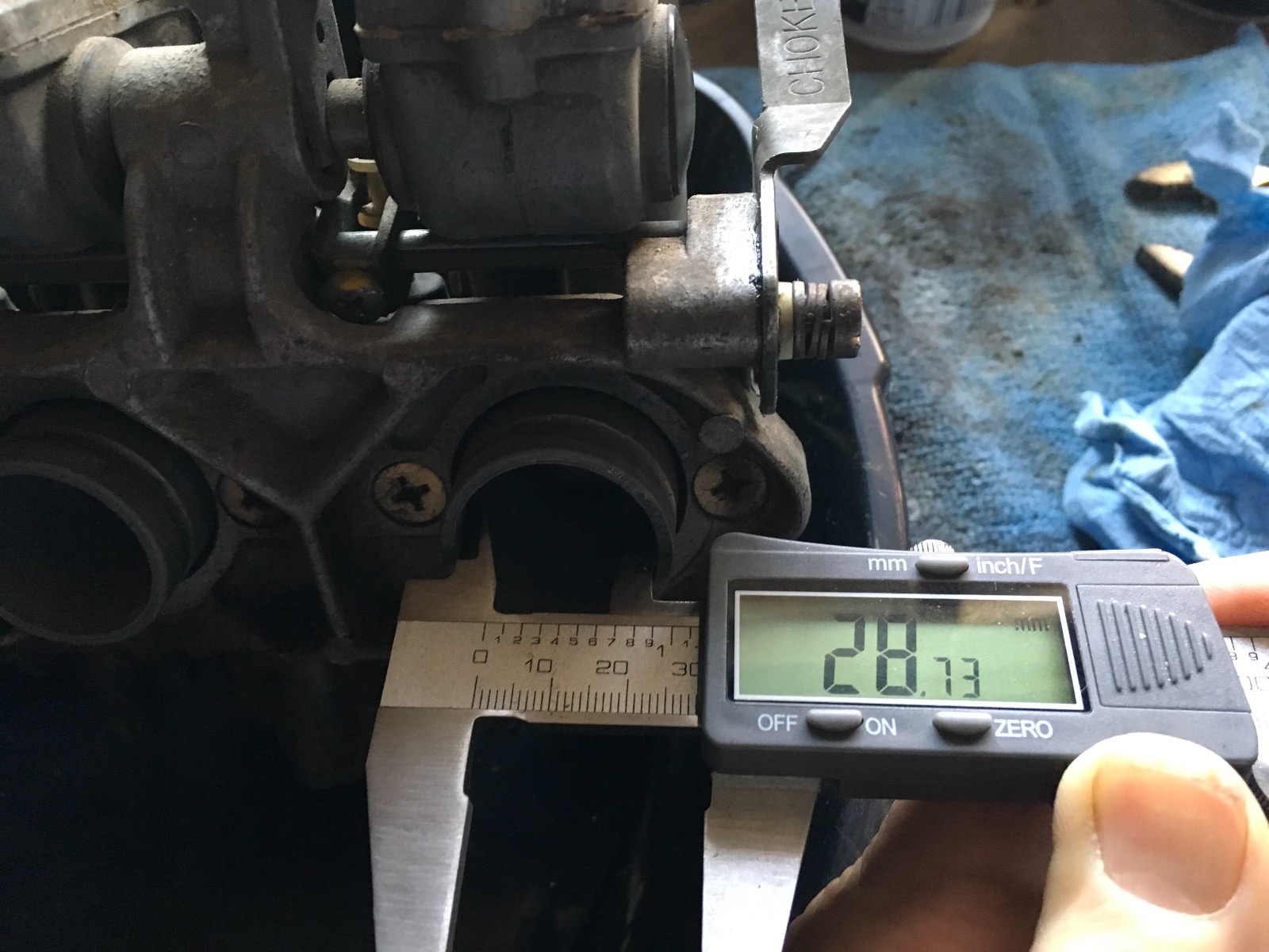

You are correct sir, my mistake they are 28 mm see attached picture. So the air corrector jets will fit this model carb and take care or all low end needs?

If your running pods the correctors work great... the best way to tell what size carbs you have is to measure the bore on the engine side... these are 28mm with pump.

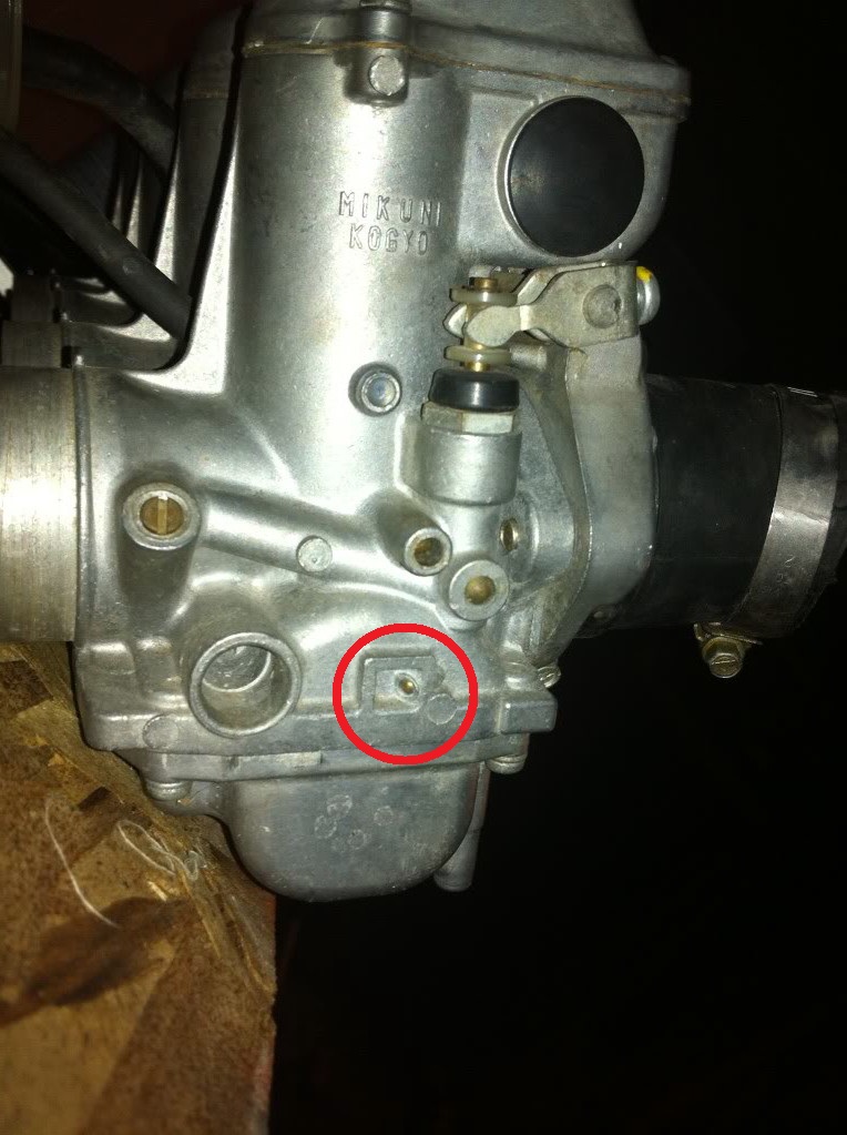

The red circle indicates the proper air passage to install the correctors
