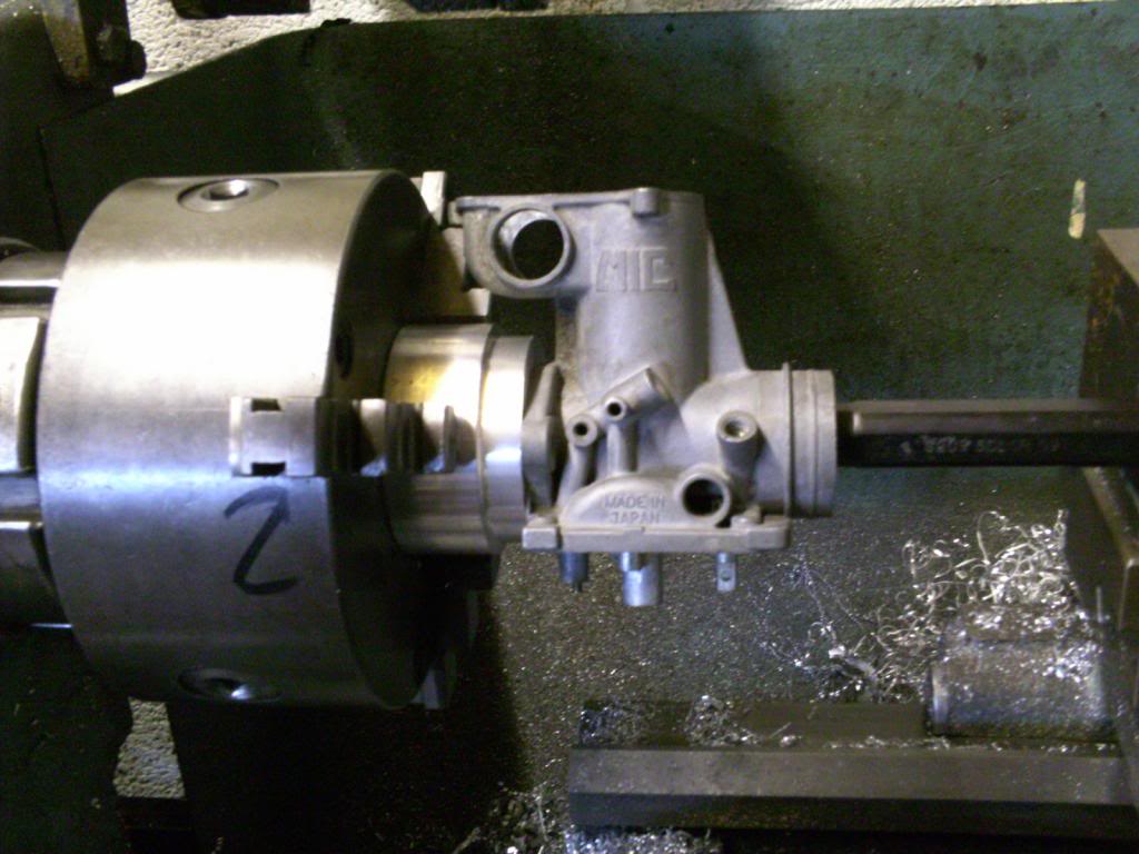

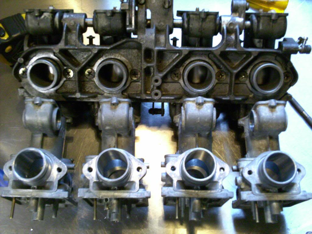

I bore out my own carbs on the lathe.
The 26mm bodies are best as they are fractionally thicker than the 28's at the stub and there's more meat between the inside bore and the bottom of the boot groove.
All the details were in my Cafe racer thread in projects but Photobucket cut all the photo links so there's nothing to see and the posts can't be edited to post new pics.
Basically you straight bore the carbs to 30mm.

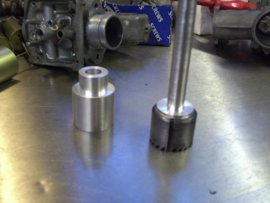

Make a cutting tool to re-instate the slide seat groove which is lost ( this has a slot up the side to allow the cutter to drop past the plastic guide for the slide )
You then need to spot face the now raised portion around the needle jet to allow the slide to fully seat and then lift the jet needle 2mm to put it back in the correct position in relation to the jet.
The slide type with the spring loaded needle and plastic spacers are the best for this as you only need to switch spacers and use a shim.
Once done correctly they out perform VM29 smoothies and are easier to set up.
Carb being bored
Before and after
Slide seat groove cutter with alloy guide that slots in after to keep it square
