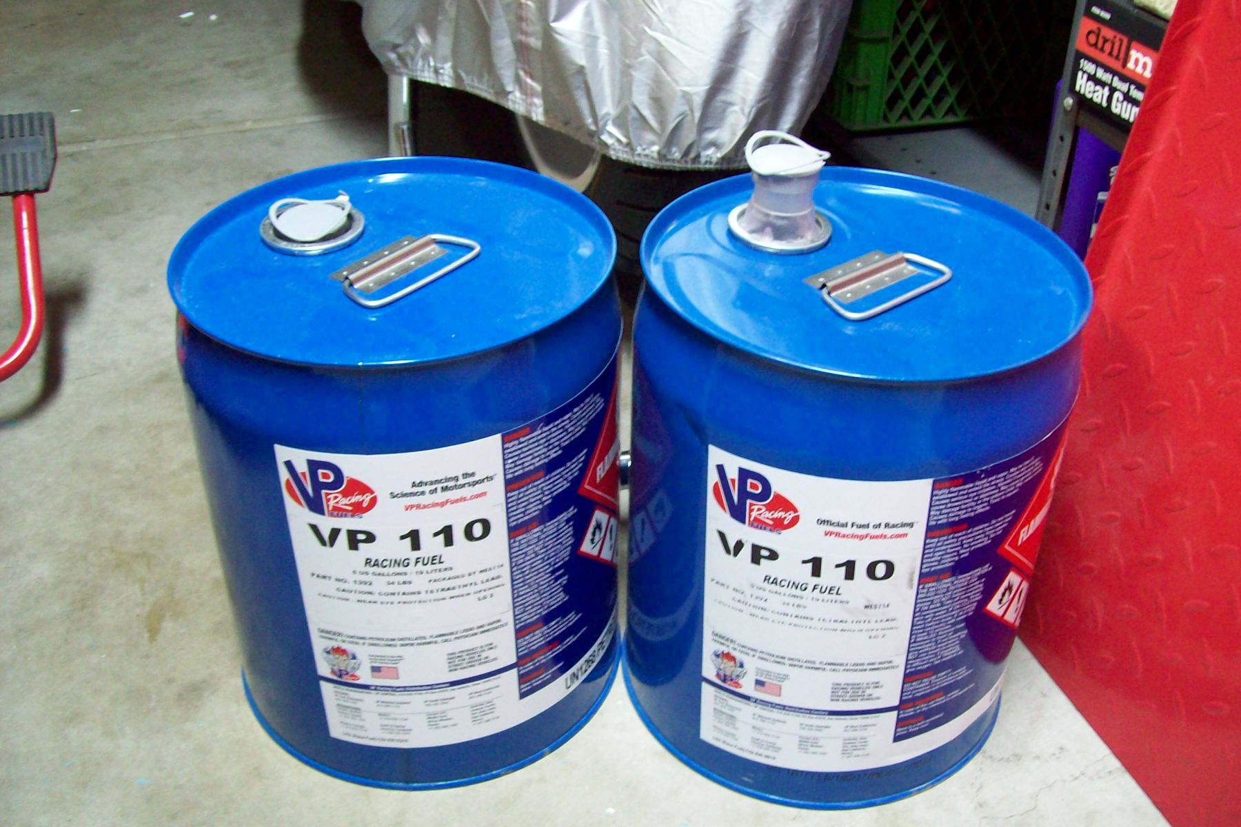

Mix in a gallon of VP110 to three gallons of pump gas and you have a fuel that you will never have to worry about denotation or any other motor problems associated with a low octane fuel. Plus it has a good amount of tetraethyl lead so your valves and valve seats will benefit from it too!!!!!
