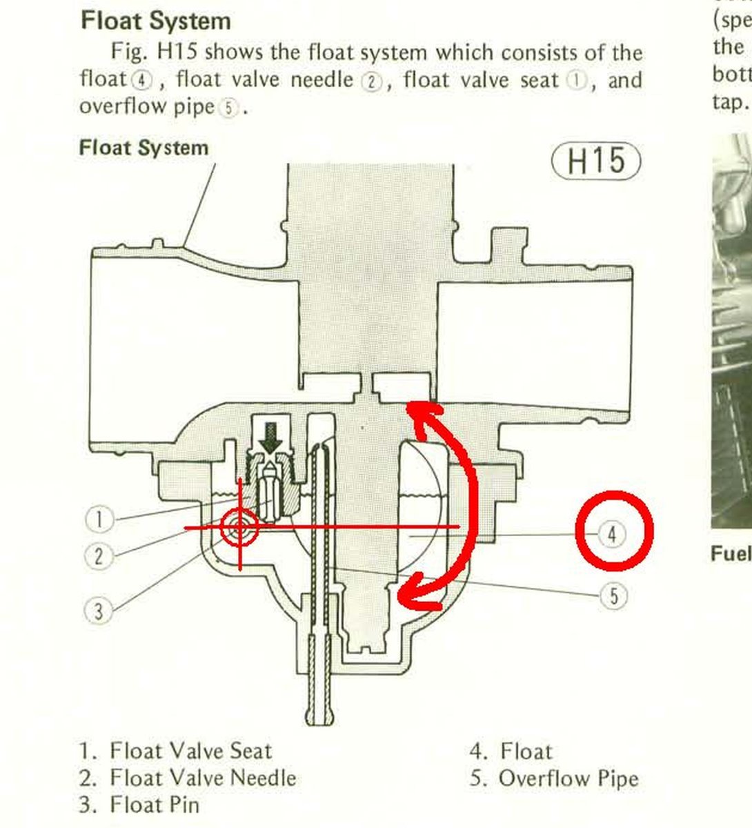

Are you sure you have any fuel in the carb bowls? Check your float orientation, because it´s be easy to put them in upside down!!!
This will lock the fload valve permanent in close position.

Unfortunately, the floats are in the right way up - also checked their height to be 22.3mm after I put them back in. I was REALLY hoping that I made a mistake like that.
