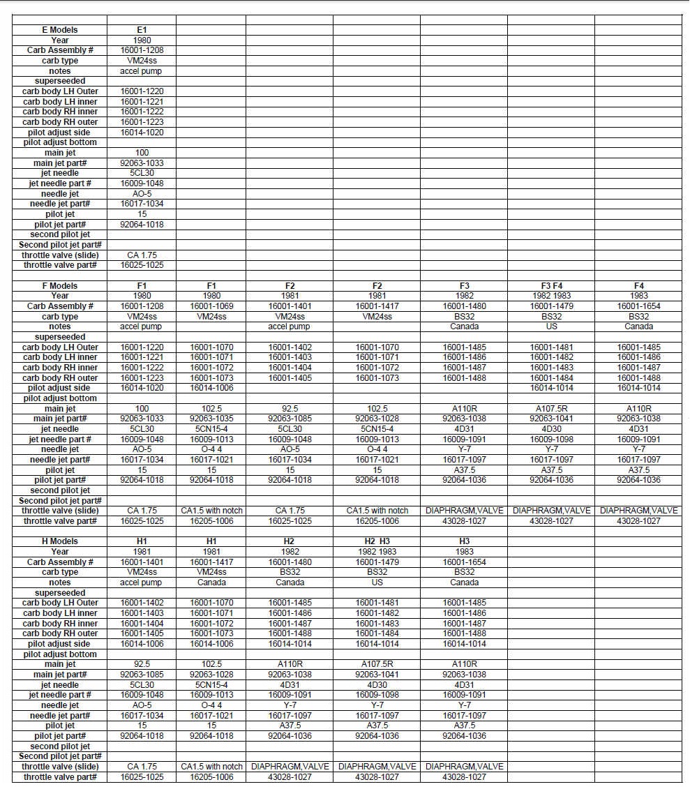

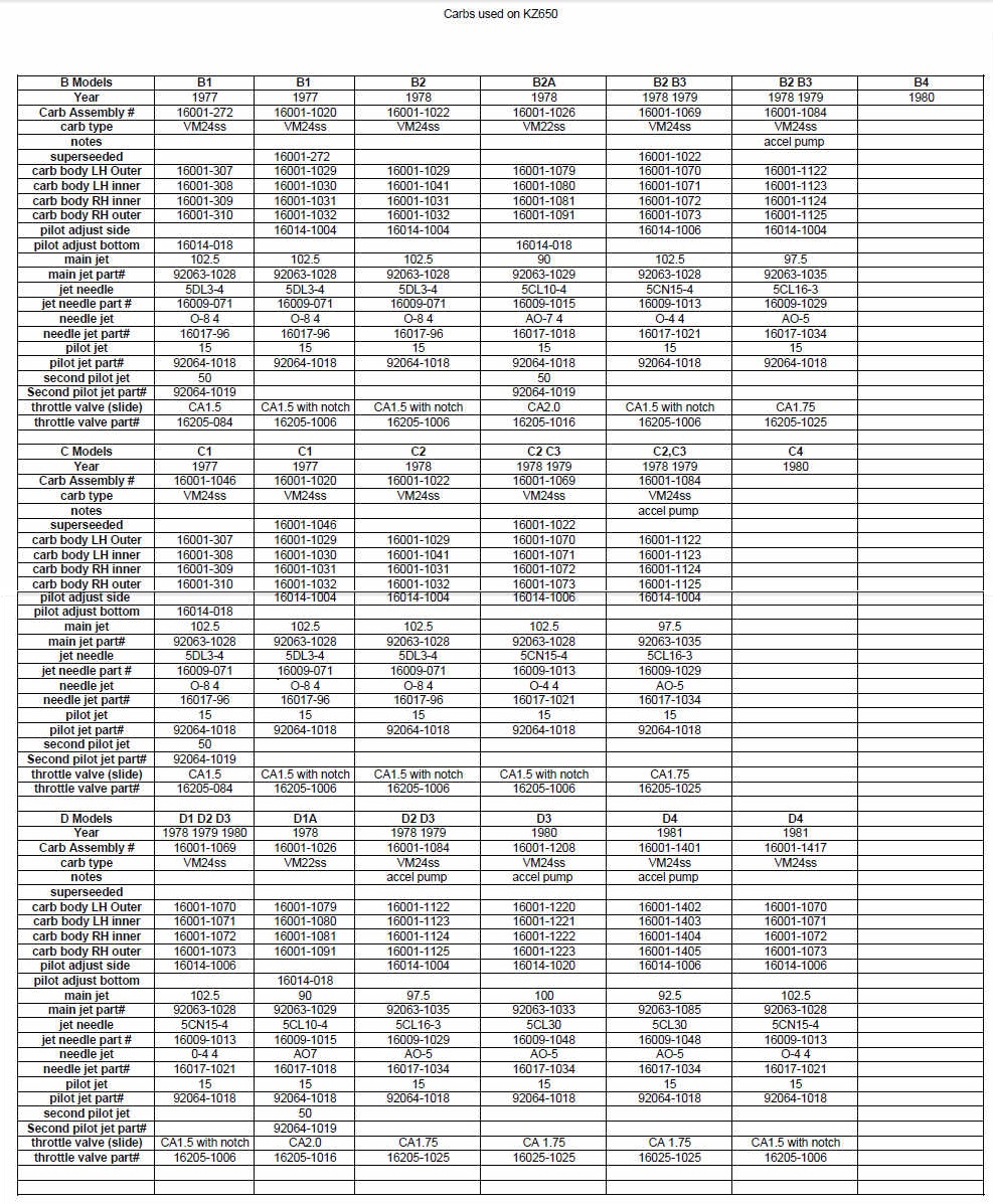

Here's a link to KZ650 models. models.kz650.info/index.htm
Here's some info regarding KZ650 carbs:
