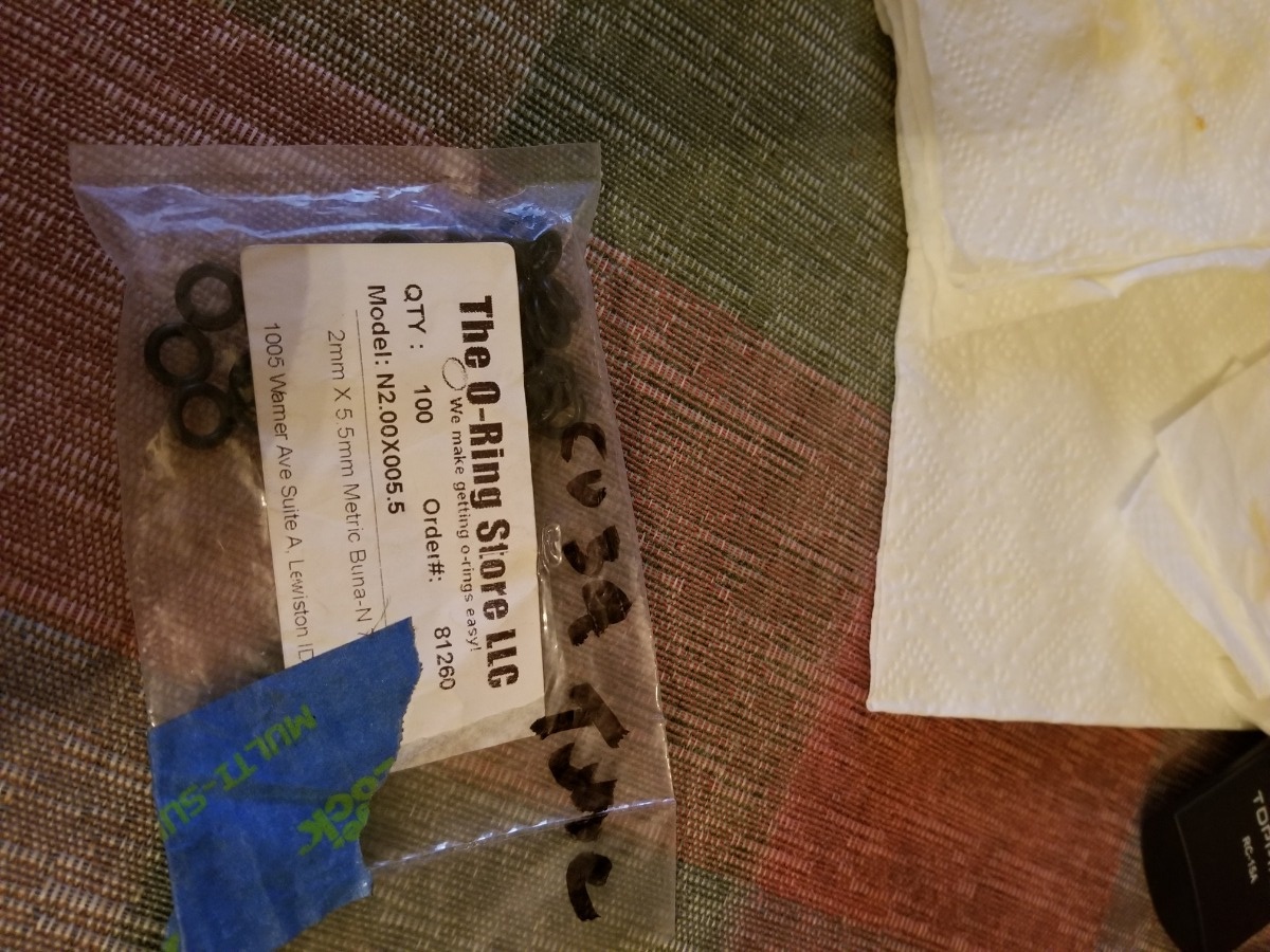

O-rings arrived from the USA, however the Tee is still leaking. I bought a new fuel hose and clamp just to make sure that it's not leading from the inlet of the T, but there is so much fuel coming out it is hard to tell if it is the o-rings or something else.
I found a post from three years ago referencing making a replacement: kzrider.com/forum/3-carburetor/605636-ke...v34-float-bowl-leaks
That is unfortunately beyond the workshop I have, but mainly the skill. Are there other common bikes using the carbs, or parts that I could use instead like the tee from the Mikuni carbs which has two o-rings on each side?

No eBay APP ID and/or Cert ID defined in Kunena configurationThis Tee seems correct for the 750...
Shipping to NZ seem to be about $20.
I can make one for you but it won't be cheaper than that.
Good luck
Good luck
The following user(s) said Thank You: bigkuri

For anyone stuck on the same problem - this eBay metal T link joiner did the trick. No difference to the naked eye, but no leaks.
The other tip I've found along the way is to only ever use a non-phillips head JIS (Japanese standard) screwdriver. The most accessible to buy are the motion pro JIS t-handle. Oh, and I realize that for most of you here this is not a tip but old news! But it took me a while to find it out so maybe handy for a another novice like myself.
Thanks again Nessism, your help has been invaluable on this and other threads.
