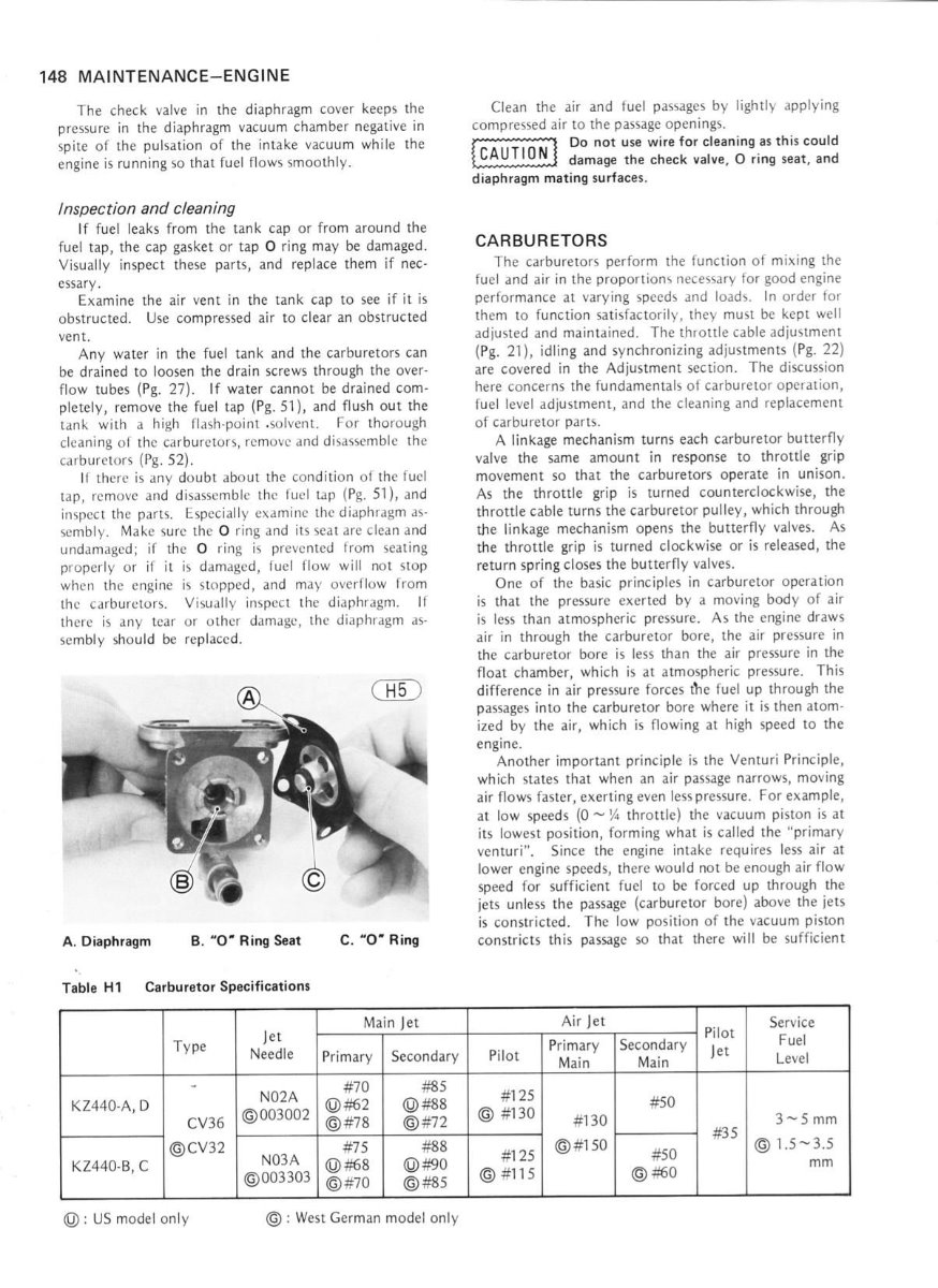

I recently purchased an 83 440 LTD Belt (see pictures). It was running a little rough so I pulled the carbs out, bought an ultrasonic cleaner, and cleaned everything real good. After I put them back in, it still isn't idling right and anytime I have the choke off and yank on the throttle, it dies so I might have an air leak that I need to check out. I bought some new boots for it so I'm going to install those also. I figured while I have the carbs out again, I'll set the air/fuel mixture screw which I didn't check the last time I had the carbs broken down before cleaning. I do not have the stock airbox. I have a set of those cheap mesh air pods so I was reading that people are recommending setting the idle screw to 1 3/4 turns out. Figured I'd give that a shot. I also would like to put a rebuild kit on it and was thinking about installing bigger jets because of the lack of the airbox. I just need to know what size jets I will need and whats a good rebuild kit to start off with. Does anyone also know the stock jet size on this model? I could not find it in the repair manual they have online. Any help or recommendations for this, let me know. Also, I did check the diaphragms out and they seem ok. I didn't see any holes in them. I'll attach some pictures. Good day, gentleman.

That is just it, I do not have the stock airbox. I bought the motorcycle as is and it did not have one, so I'm stuck with the pods. I don't mind re jetting, it's simple to pull off the carbs and pull out the jets so not a big deal. I just need to know where to start with jet sizes and kits. And I have the online manual saved in .pdf format so I'm all good there.

If not, then the first step is to find a reliable source on what jets were originally in there. A manual might have it, or a parts fiche on a website might have it. If all that fails, then you will have to hope someone posted it somewhere.
Before you start with the jetting, though, the process starts with a compression test, and valve adjustment. Then confirming the ignition timing. Then fixing vacuum leaks. Then confirming fuel flow and setting fuel levels. Then the jetting fun can start.
