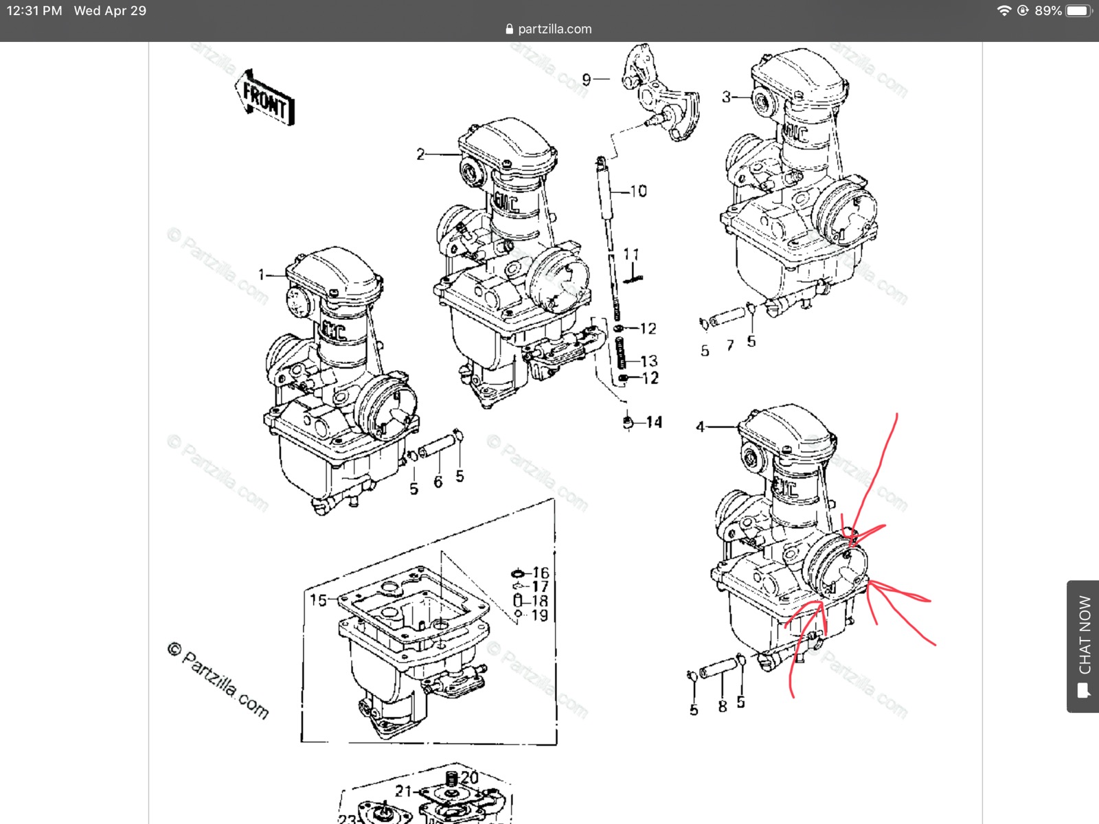

+1 on checking the carb holders for leaks. I would also make sure to check the vacuum stems on the carb holder and make sure they are sealed as well.
It sounds like your pilot circuit is clogged. Or at least that’s my guess as it will idle but won’t rev, had the same issue on my ‘79 SR when I first got it.
On a side note with pod filters, make sure they don’t cover the orifice on the intake side of the carbs. (Assuming you have the stock carbs) Some pod filters have a lip inside them that will cover those holes and cause tuning problems, but can be solved with careful clearancing with a utility knife.
