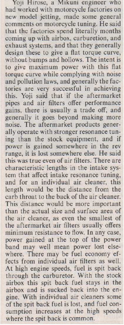

For best overall performance and to keep from spending a lot of time trying to find the magic combination of jets, etc. your best bet is to find a good airbox and use a Kawasaki air filter in it. Expert engineers at Kawasaki / Mikuni spent a lot of time developing the airbox and ensuring that it works well and delivers good power under all throttle positions. Keep in mind that while you will see pod or in fact no air filters on various race bikes those bikes are pretty much run at wide open throttle most of the time, so for them riding at normal throttle openings is not an issue. The image below gives the perspective of one of the Mikuni engineers. Ed

You should get the bike running in stock form first and then modify it later to suit your taste.
Stock these bikes run pretty good. The KZ750/4 has some aftermarket support, cams , pistons, exhaust and intake.

If the carbs are properly cleaned and the airbox installed (with properly sealing boots) there will be no questions relative to jetting and such when you go to fire the bike off. You are guaranteed that the bike will run perfectly. With pods there are jetting questions and trial and error required. Not to mention a set of real K&N pods and Dynojet kit will set you back $300+.
