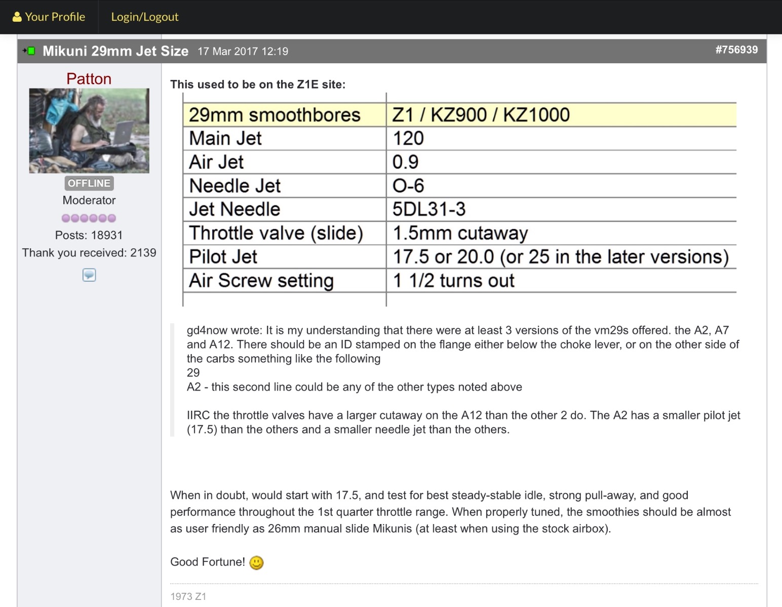

- Posts: 4836
- Thanks: 1851
Re: Mikuni 29mm jetting help
06 Apr 2020 18:53
- Posts: 4836
- Thanks: 1851
06 Apr 2020 18:56
If you search bing or goggle with “29mm mikuni KZR” you find lots of data. You pick what works for you.

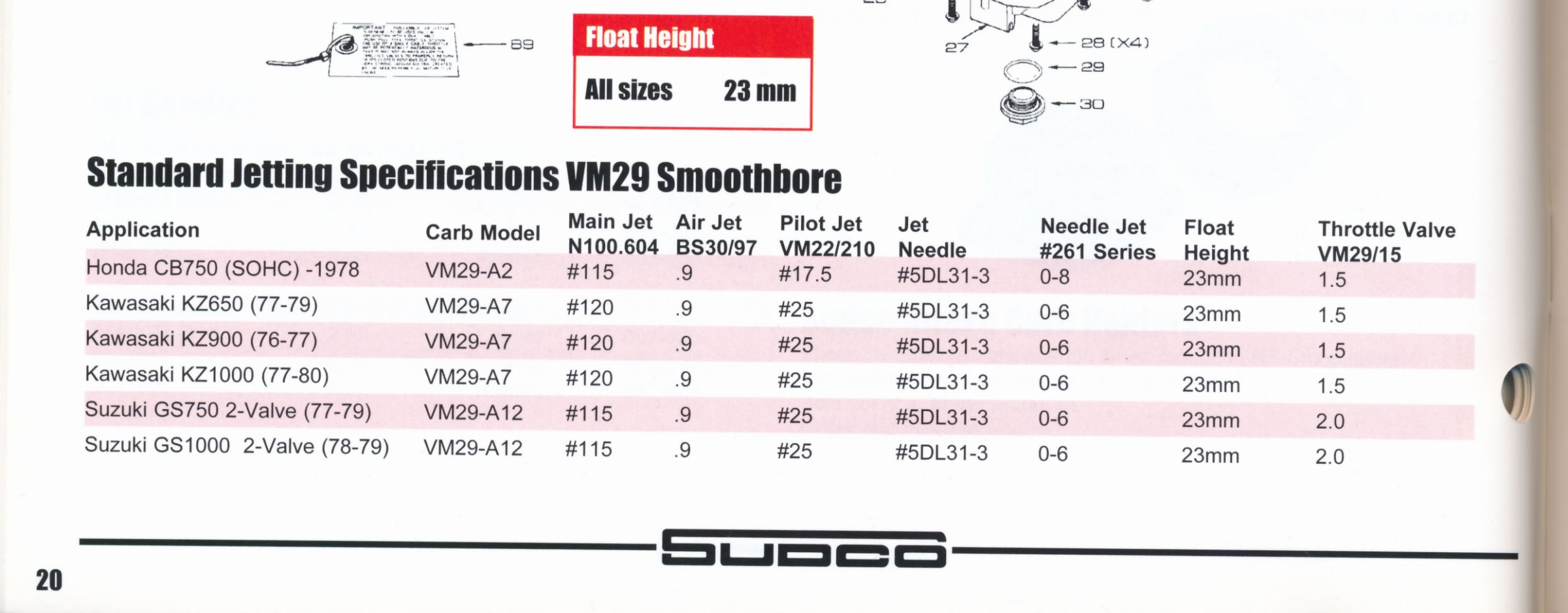

Sudco has a carb tuning manual. I have the 5th edition. They provide a table with a recommended starting point for VM29s in different applications. I'm assuming these will tend to be on the rich side, but it's a good reference.
