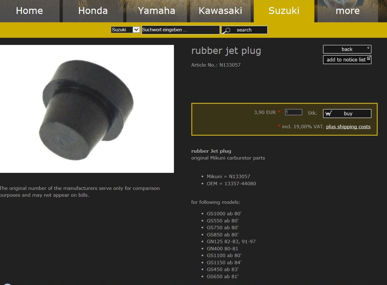

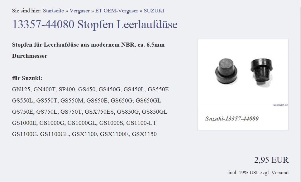

In the USA the Suzuki dealer probably has them.
Partzilla >> Suzuki 13357- 44080
