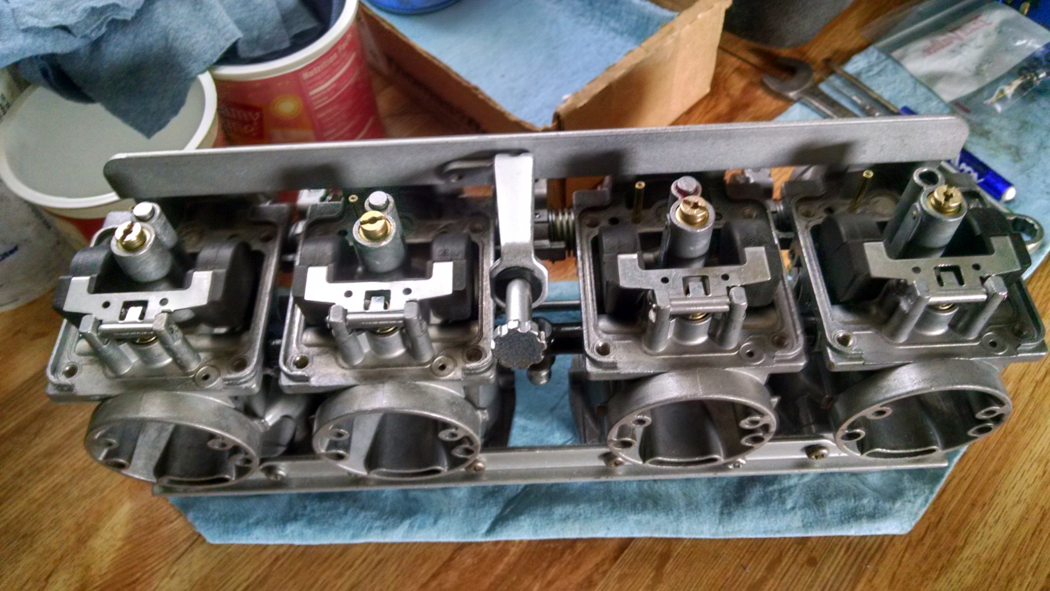

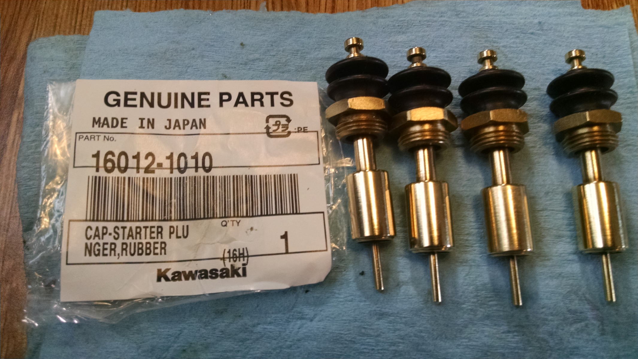

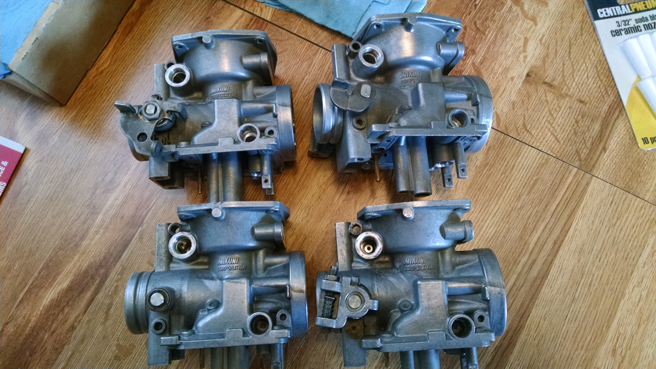

My friends give solid advice. Take them apart again and concentrate on the pilot circuits. There are also some little plugs under the pilot jets that must be in place for them to operate properly. This means unganging them to take apart the "choke" (cold enrichment) circuit to clean out the passages.. The tutorials for the >correct< carbs lay it out well.
These are 81 Kz1000 carbs.
Notice the small plugs by the main jet. **Note #1 is missing. I was hunting the o-rings.
Brass polishes nicely.
