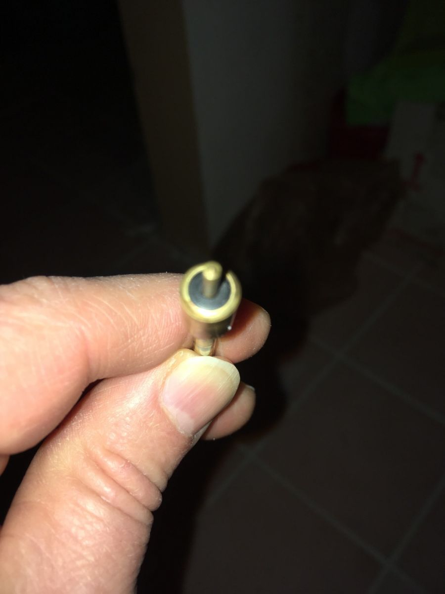

I would love to hear any ideas on how to replace the small rubber pad at the bottom of the brass fuel enrichment plunger .
Thank you Greg

I would get some sheet nitrile or viton rubber & use leather hole punches that makes hollow holes.

I’ve thought about this also. Have you tried to get the old one out yet. The heavy roll on the end might make it difficult to reinstall without damaging the rubber

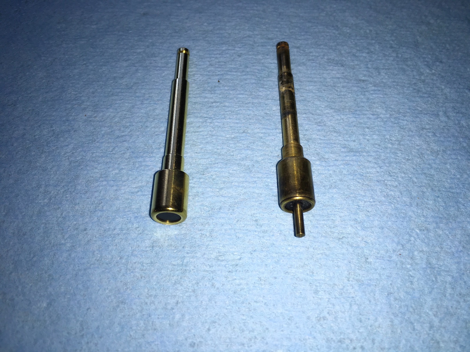

Yes! I have been offering a plunger re-seating service here in the UK using modern fuel resistant Viton.
It was mainly for the early obsolete plungers on the SC carbs but will do the late 24/26/28 SS as these are also obsolete as a genuine item and pattern ones are scarce with the Keyster ones only available in the big rebuild kit and they don't have the brass needle attached which isn't good.
It's £50 per set + post but I haven't advertised overseas or on the forum because of the two way shipping .
It's a tricky process as the original seats were installed and the brass edge rolled over to secure them.
With the tooling and jigs I made I can fit the same size pad without disturbing the rolled edge so that the seats are held captive as original and not just undersized and pushed in the hole.

I've tried the Keyster choke valves (with the flat bottom) but gave up on them. Carbs seemed to be unstable at idle. Why do they not work as well as the originals with the point on the bottom?

Do the Keyster parts have the rubber seal?

07 Mar 2020 10:07The Keyster ones do have a rubber seal but they don't have the brass needle so don't have the sensitivity of the originals.TexasKZ wrote: Do the Keyster parts have the rubber seal?
The brass needle acts like a jet needle but a bit cruder and allows the fuel to be feathered in.
The ones without are more all or nothing in operation.
