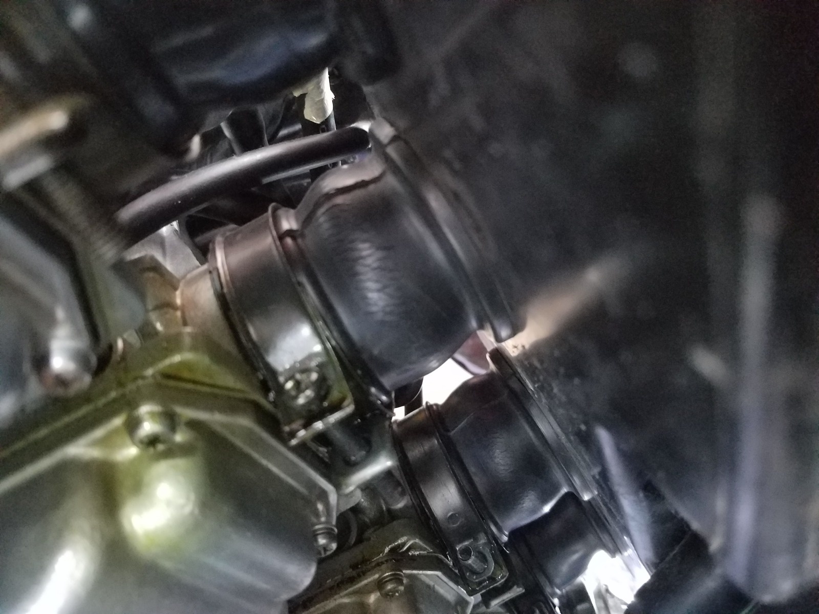

KZriders : Can you offer any insight on the image ?
It sure looks like oil mixed with fuel leaking from the carb bowls.

No, it`s only fuel residues, (bowl gasket leaking).

And so, it Looks like more work with bowl gaskets and Allen heads screws. We'll add to the list.
Just guessing, but most likely the seeping fuel residues (yes, it is oily to the touch ) within these old carbs may require additional carb rebuild work ?
She (78 kawasaki ltd) starts and runs good) .

For the oily seepage / residues from my posted image. I was also thinking potential valve intake issues . For example , an adjustment may be needed because of the age/ wear.... allowing oil to pass thru intake ? No?
Summary, No white smoke or real evidence. Again, She runs strong.

03 Mar 2020 13:2778kawltd wrote: Thanks Scirroco and Mikaw. We'll proceed with caution.
Mine did the same thing when it leaked a few years back....... would have bet money there was oil in the gas but it was just the gas leaking by the old gaskets and taking some gasket material with it. Another fan of allens too just go easy like said.

The bowls will leak when fuel in the bowl is higher than the gasket. Leaving the bike on the side stand will allow fuel to ride high on one side, causing the leakage. Improperly adjusted floats will also do it. Leaky float valves are another possible source, but this problem usually results in leakage through the overflow tube.
The solutions? Leave your bike on the center stand when parked. Shut fuel off just before you get back from a ride to burn off some of the fuel in the float bowl. Adjust floats and check float valves.

Hardrockminer, / and all. yes ,that would explain the angle of the residues, seepage, stain, etc. IE, left side only. Later, We'll plan probe deeper with the potential float problem...

We've come to the conclusion that the old fiber carb bowl gaskets are very slightly porous. Gas is thin stuff. After years of soaking, gas weeps & leaves that varnish residue. Adds to patina... :dry: Carb makers went to synthetic O-rings for good reason.
On Z1 carb gaskets, we use the thinnest possible wipe (just a sheen) of Permatex Ultra Black #22072. It releases cleanly & allows used gaskets to be reused many times.
Not a fan of Allen screws for float bowls; we've seen too many otherwise decent carb bodies Bubba'd by over-tightened Allen screws. A good JIS screwdriver can over-torque stock cross-head float bowl fasteners the way it is. We don't tinker with jets anyway, so it's not been an issue except when we have to deal with the aftermath of a PO using Allens.
