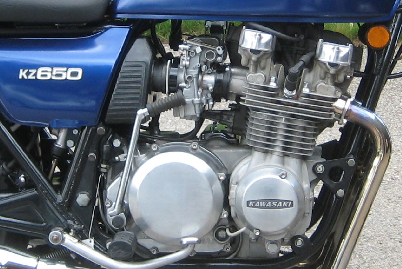

I have a set of TM33's installed on my KZ650, your going to find you need a pretty big pilot jet to keep it idling OK for the street. You put a big carb on there for the motor size and it needs a big fuel signal to make it work properly.
On my setup the motor is 831cc, head is big valved (35/29) Stage 3 port job with .400" lift cams.
Generally a 27mm flat slide is just about equal in flow to a 30mm round slide. If you think about it in those terms you would need bigger valves and higher lift cams to get the air flow needed to match the carbs, if not the motor will just bog when you open the throttle. Most hot 550's out there would be running the Keihin CR26's.
These carbs are very similar to the VM29SS Mikuni flat slides they put on 1984/85 Suzuki GSXR750R street bikes. These came out before the RS series flat slides which have the throttle rod located on the opposite side of the carb body to the slide.
Mikuni does still make the TM33 as a single carb for motocross, so a lot of the parts are still available, not sure if they would fit the 27's. Suzuki still carry some parts for there 29mm version, not sure if they are the same either.
I have a set of those early GSXR 29's and they are almost identical to the TM33's in the picture.
