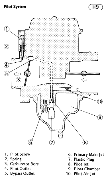

I have the feeling it is the pilot screw (see picture). How do I know this is in the correct position?

You said you replaced the carburetors. Are they the same make and model as the stock carburetors? If so, are the nylon plugs (#7 in the diagram above) installed and snug fitting?

I only cleaned the carburetors and changed the main jet. Furthermore, the picture I send of the scematic carburetor is not 100% correct since it is from a KZ750 and I have a KZ700 (with the origional carburetor). My carburetor does not have the plastic plug btw.
