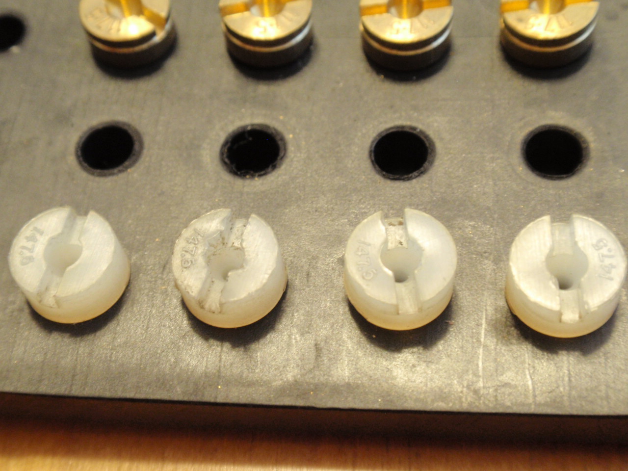

Here's a set of plastic 147.5's for you. Never used them back in the day. Not sure how I came to own them. Notice how the heads are all chewed up. Junk!
Mike
Mike
