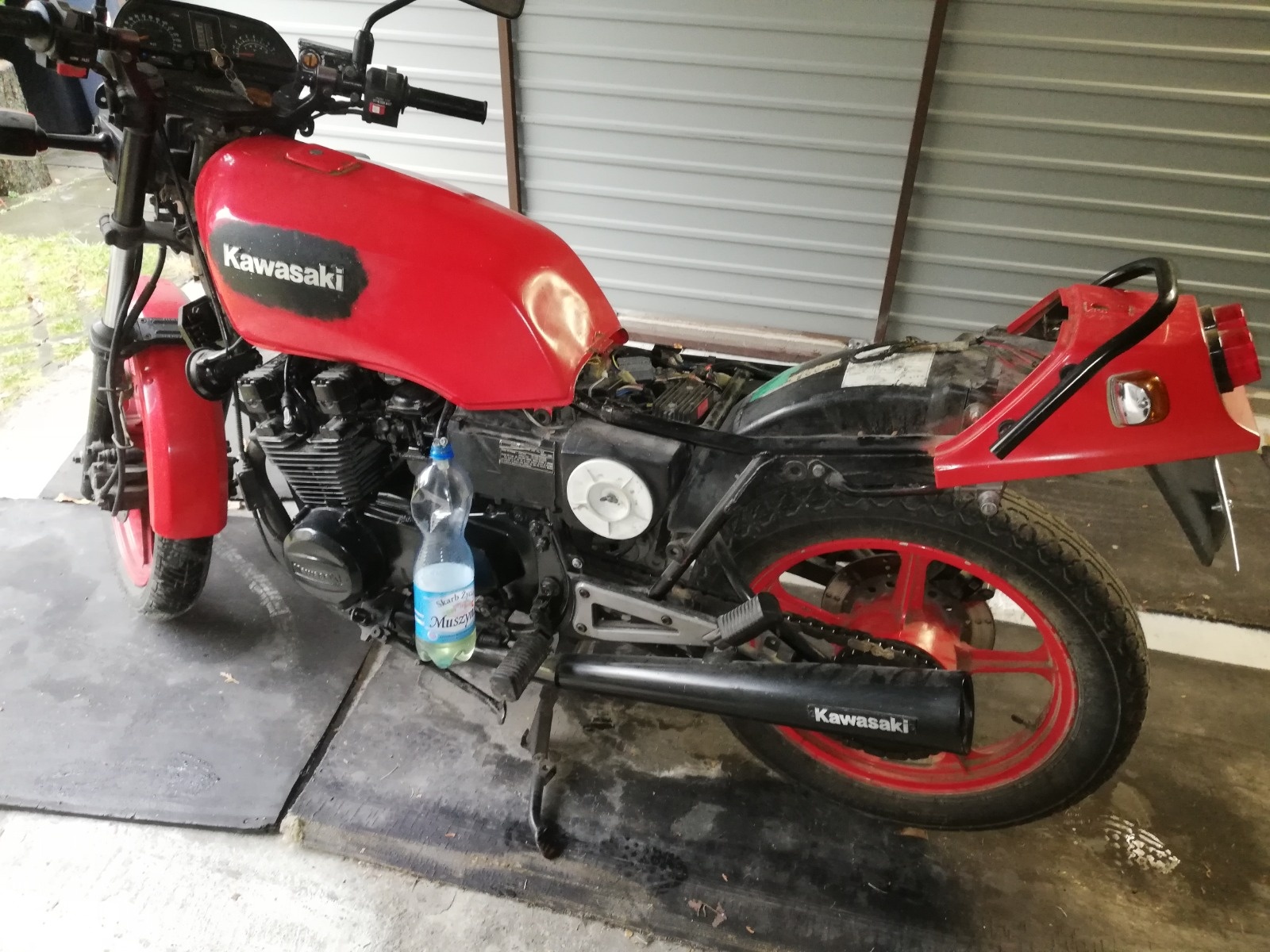

Do you have a photo of the bike? The 1984 Gpz model started manufacture in 1983. So maybe you have an 84 model but it was built in 1983. The 84 model came with Tk27 carbs.

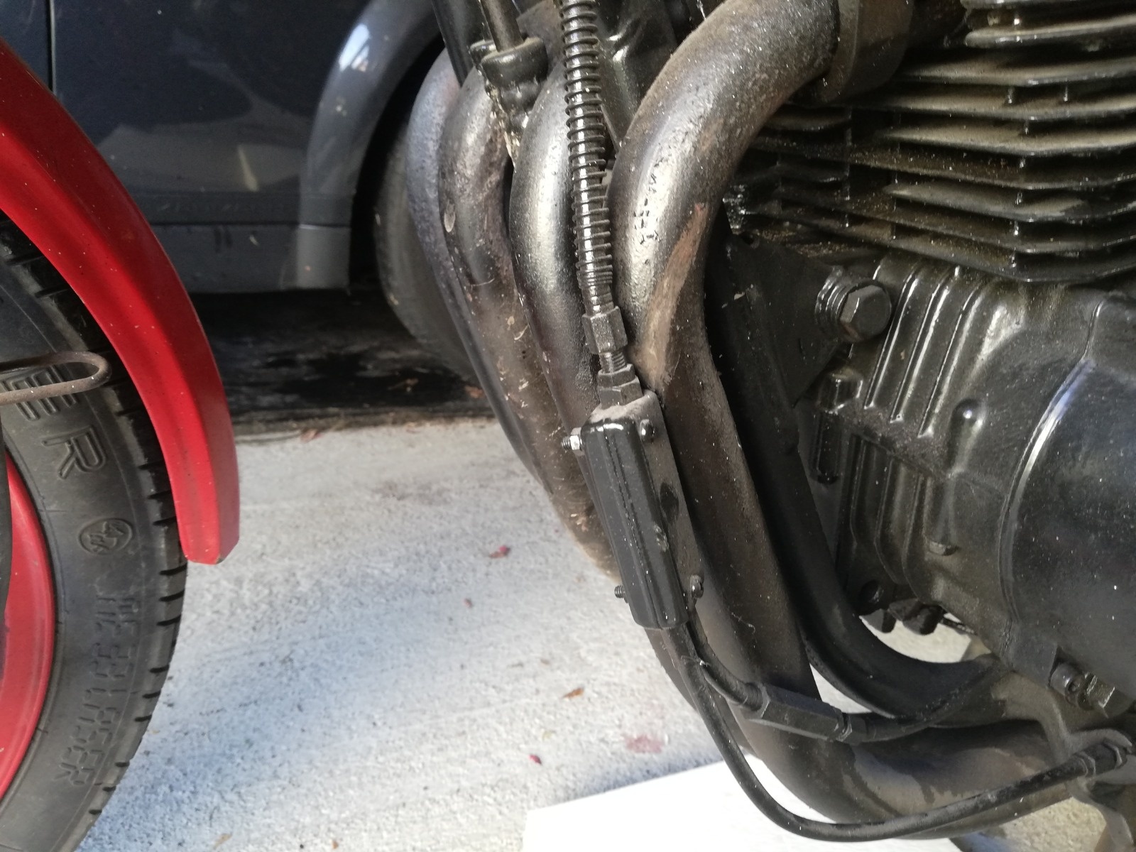

The 82/83 Kz550H Tk26 carbs had the idle screw in the middle of the carb rack.
Your photo shows a remote idle knob.

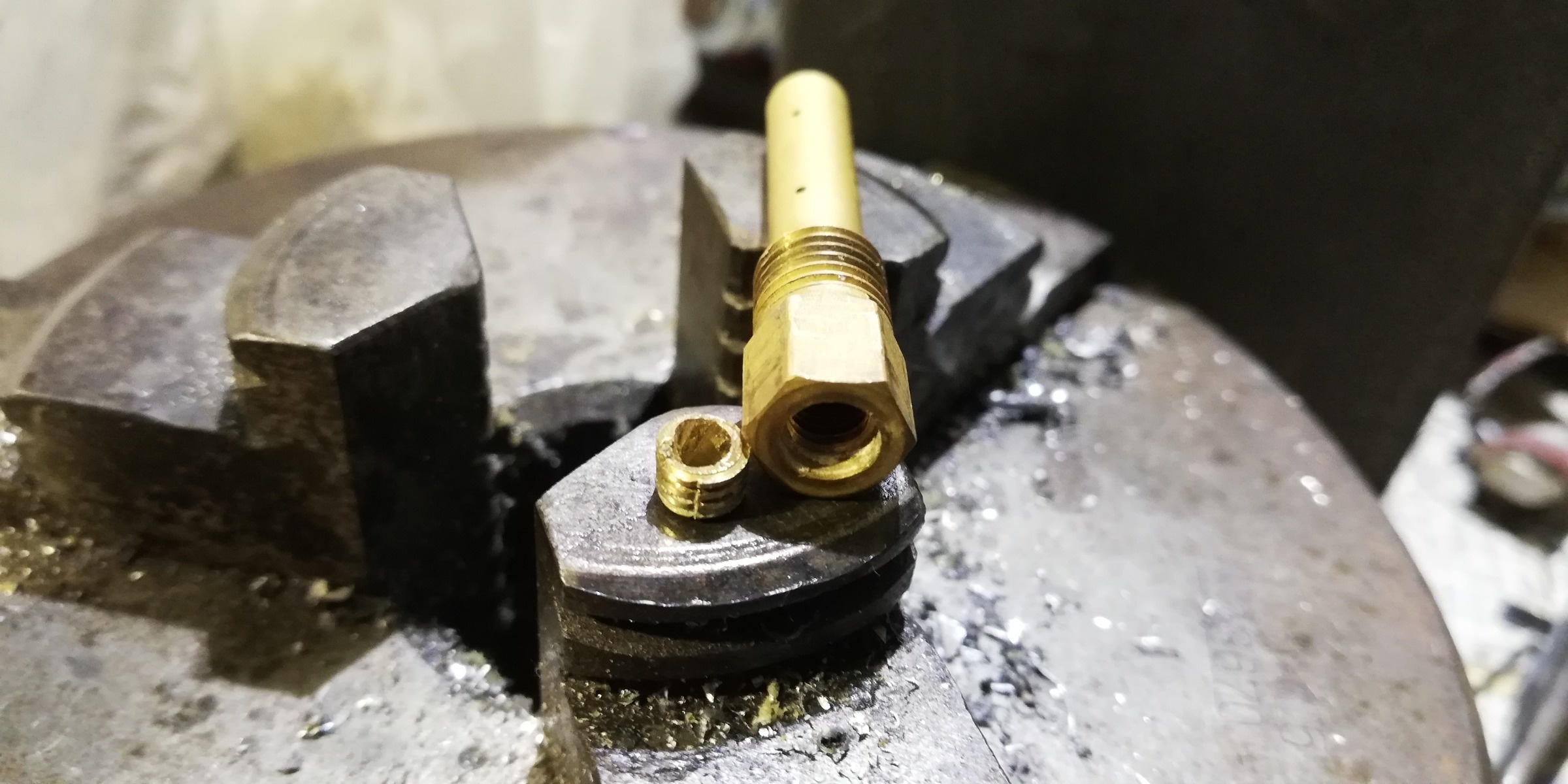

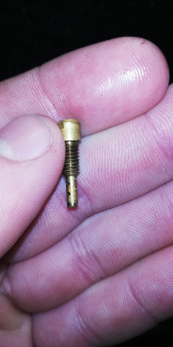

Do you have a photo of the broken jet holder (aka main emulsifier tube) ?

Here are the photos, I don`t see any numbers on pilot jet but on the main there is "14". The needle is 4A10 I`m sure.
Bike has been repainted or stickers were stripped
and my blinkers and tail light isn`t orginal I think

Ok, so that bike is a Kz550H (Gpz). If it's an 83, then it's a Kz550H2. (82 is the Kz550H1).

Fortunately, I was able to remove the broken jet without damaging holder screw. I'm waiting for Keihin jets to test-fit them. Soon I'll post project thread about my GPz and provide some photos and more info.

Ok, I see now. I thought you needed a new jet holder because the jet holder was broken, but it was because the jet was broken in it.
Very nice job getting that out. The jet holder would have been difficult to get by itself.
