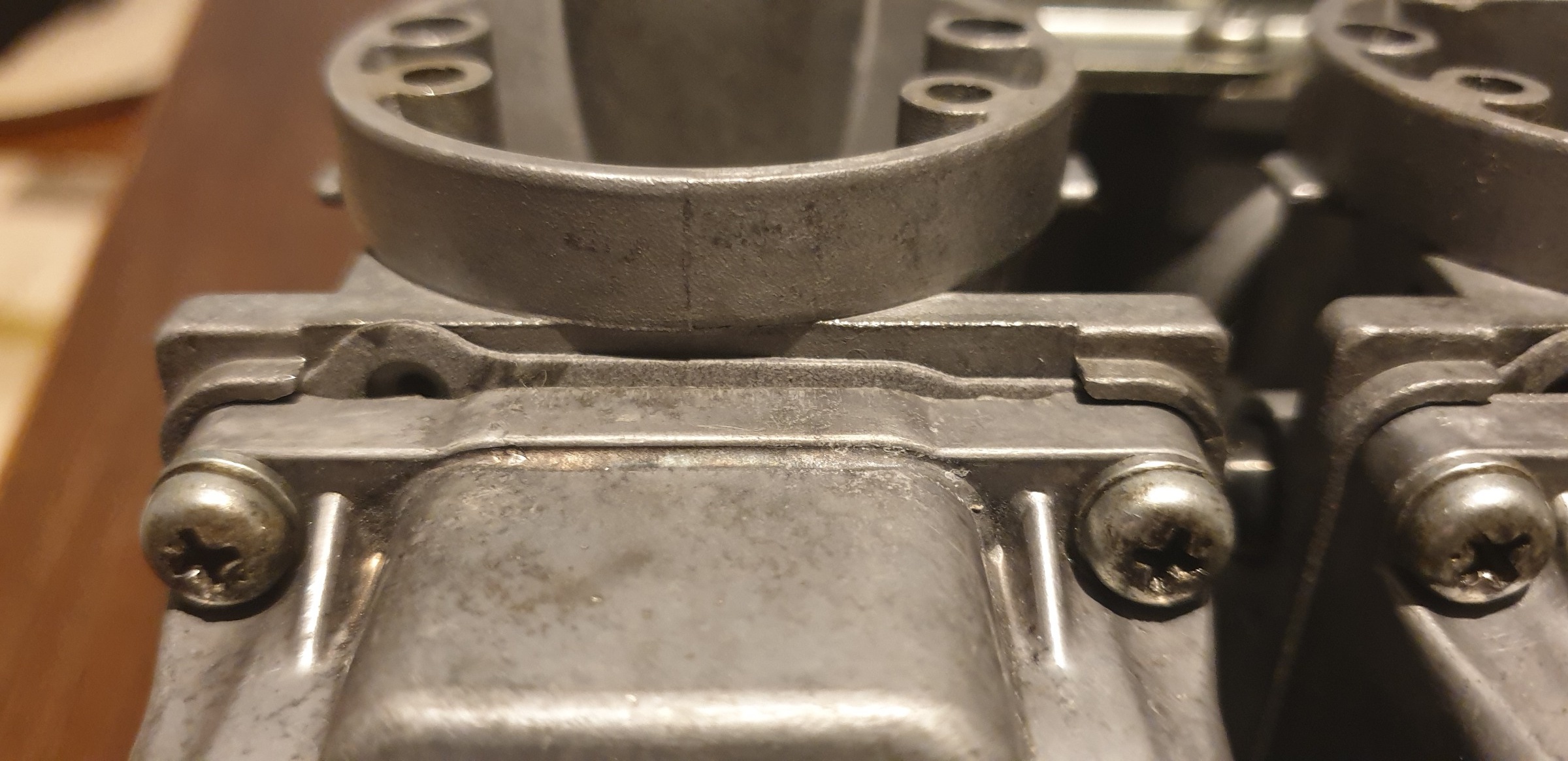

Re: Csr jet sizes.
20 Nov 2019 14:21Hope this is a better picture. The gasket seems to go round a hole in the bowl. Is this normal ? Will the fuel come out of here or should the fuel level never get that high ? Sorry for looking dim but carbs are all new to me !!
