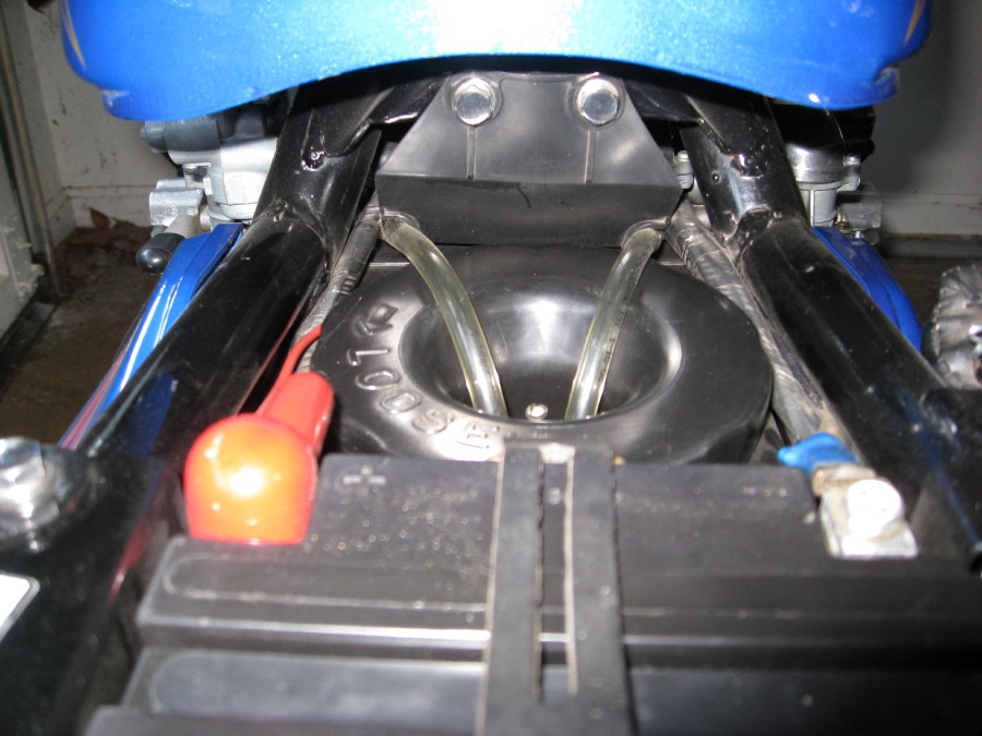

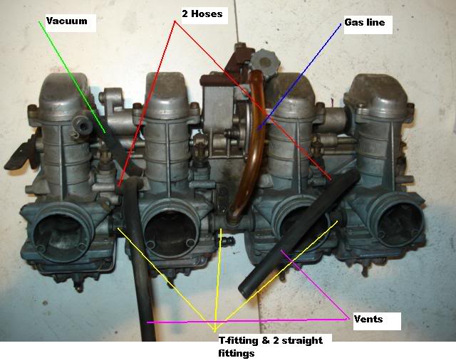

I do not believe those will be vacuum fittings. They should be ports for vents that will allow the fuel level in the bowls to vary properly. They should have hoses attached to them which then vent to an area under the seat at the carb air filter. In any case they need to vent to open air and not be blocked. See "VENTS" in the first image below. The second image below shows the setup on my 1977 KZ650-C1. If you block them the carbs will not operate properly. Ed
